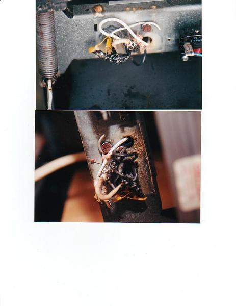

Just removed a dishwasher and heres the electrical connection!!
Sweet. I particularly love the arc marks on the frame. Always a sign of quality electrical work. Welcome to the wild and wonderful world of improvisational electrical construction. Every service electrician I know has tales of wonder and horror that our new construction brethren, and sistern <G>, only see in their dreams. You never know how HOs or neighborhood hacks will do things. Some get quite imaginative.
I knew I was in a different world the day I opened a box and found connections made up by winding the connections with wire bread ties and insulated with band-aids. I have seen connections twisted together and floating uninsulated in the middle of steel junction boxes. Iron tie-wire used for wiring and cellophane tape used as insulation. I have also seen toothpaste used as an antioxidant used to make minty fresh CU/AL connections. Not knowing, or caring to know, any better people are limited only by their imagination and availability when considering the tools, techniques and materials used
I was surprised to see that the Home Despot carried CU/AL rated and anti-oxidant filled wire nuts in handy packs. Given the availability of the proper connectors it is just a matter of pigtailing short leads and replacing the line. The best of luck to you.
"Iron tie-wire used for wiring and cellophane tape used as insulation."
On the last DW install I did I found wires in a juction box twisted together and wrapped with a blue cellophane tape. I told them they should have the entire house wiring checked.
