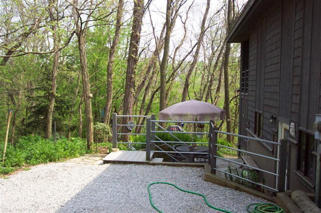

    .View Image

      Will check the building codes, for sure, though somehow what I currently have passed muster (the house had to be brought up to code to get the VA loan approved...that was a big mistake...)I like cable systems, though these rails actually need to be practical...useful for the kids walking up the stairs and such.Calvin...what do you have there, wood posts + galvanized conduit? Looks nice (and sounds affordable!)Location = We're in the Twin Cities (MN)
      1. calvin | Jun 02, 2006 01:22pm | #6
        yes, rigid and cedar posts.
        Code allowed due to being under 30'' above grade.  In many jurisdictions, horizontal rail is climable and not allowed.A great place for Information, Comraderie, and a sucker punch.

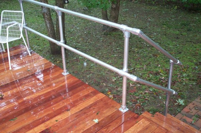

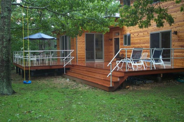

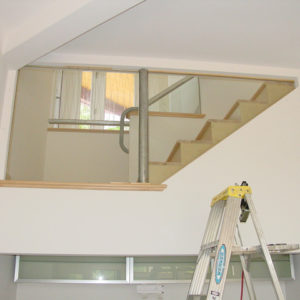

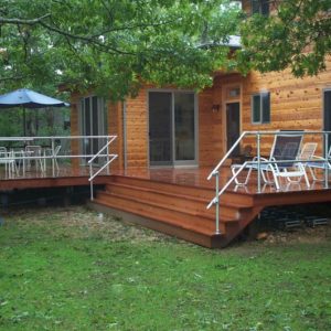

    Speedrail - Aluminum pipe and fittings - DIY.
    Edited 6/2/2006 4:53 pm ET by TGNY

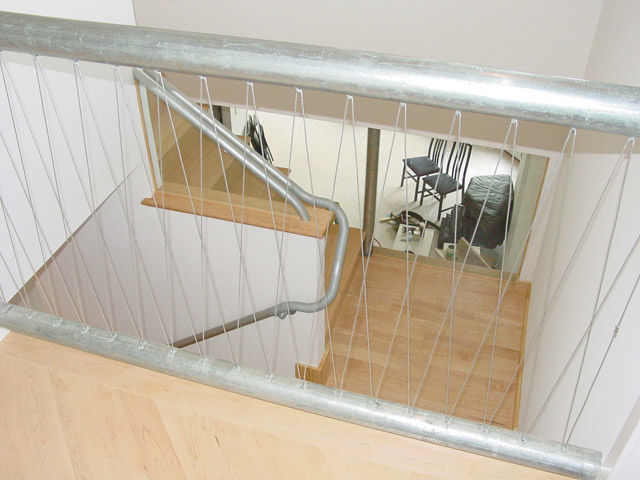

    1. Snort | Jun 03, 2006 01:20am | #14

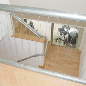

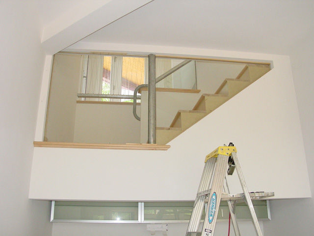

      Here's one with a little bit of everything. The HO did all the metal work, and there's 3/8 glass in the parts that look clear<G>Everything passed final inspection, too. I need a dump truck, baby, to unload my head
      1. Snort | Jun 03, 2006 01:21am | #15
        Sheesh! I need a dump truck, baby, to unload my head
        1. joewood | Jun 03, 2006 01:49am | #16
          Hey Snort, are those just little eyelets in that first pic, where the cable is going up and over, and is that stainless cable? Seems like stainless wouldn't bend that much without kinking.
          1. Snort | Jun 03, 2006 04:04pm | #18
            Hey Joe, yeah the HO welded on the eyes. Now that you mention it, I'm not sure if it's stainless cable, or some other kind...he did get pretty danged tight, though. I need a dump truck, baby, to unload my head
          2. jimblodgett | Jun 03, 2006 06:09pm | #19
            I bet you could use nylon line, like a real heavy fish line, if you wanted to.  That will danged sure hold 200 lbs.Tipi, Tipi, Tipi!
            http://www.asmallwoodworkingcompany.com
