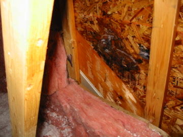

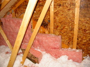

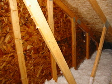

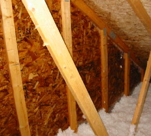

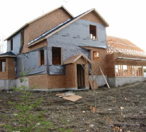

I just discovered water on the floor of a second story room which is unfinished at this time.  The water had accumulated along one wall, in the “bonus” room which has a cathedral ceiling with a salt box style roof. The salt box roof line is lower than the adjacent roof line (which is 8/12 pitch). (in Maine by the way)
In the attic, the wall on the eave end near the salt box roof line was soaking wet, almost the entire wall. There was also frost in certain areas on the wall. Since the whole wall was wet my guess is that I have an interior moisture problem that is making its way into the attic, condensing on the wall (which also happens to be the coldest wall on the north side), forming frost, and then when we have a warmer day, it starts to trickle down the walls.  This is my theory anyway (rather than a roof leak)
I should mention that over the last couple weeks we have run humidifiers frequently, perhaps more than normal.  I have looked into other sources of moisture and have not found anything unusual.
What are my options?, other than the obvious, which is to tone down the humidifier.
Pics attached.  Thanks for any advice.

    Wow, those are some dramatic pics! It does appear that the entire end wall is wet, but the rest of the attic is dry??
    It would be helpful if you could tell us about how the house is detailed...is there a crawlspace? a basement? How is it insulated?
    How are the living area walls insulated?
    You've just finished building?
    How tight is the house? When you open the door on a cold still day, is air blowing in?
    Someone who used to post on this site used to say that "a dry house is a leaky house".  If you are running humidifiers, it is because too much of your air is moving freely into the attic, allowing dry outside air into the house.
    Between the crawlspace/basement, dishwashing, bathing, breathing, etc., there should be enough moisture in the air. Since there isn't...
    You probably have to address the origin of the moisture and the manner in which it is getting to the attic.
    First I would suggest that you seal the attic floor.  Go into the attic and go over the entire floor foaming shut every little crack, crease, and hole you can find.
    Then see how dry or humid the living area is.

      The drywall you see from the attic is where the peak of the cathedral ceiling (in the salt box portion) meets the attic under the adjacent roof.  I didn't look at it too closely after I peeled the insulation back, but it does seem like there should be some sort of nailer in that area. I'll check it out.

        If the air is blowing in at the highest window in the house, you probably still have some sealing to do. I would look very closely at the base of the wet attic wall...since that is what is wet there is a chance that the leak is right there.

    In one of your photos I noticed that you can see the top of the drywall from your attic.  Hoe did that happen?  Did they skip the nailer at the ceiling or add the nailer after the wall sheetrock was in place, which means they would have sheetrocked the ceiling last??  Doesn't make sense to me, but I don't know all the drywall shortcuts.

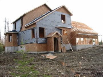

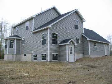

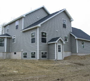

    Is the attic or bonus room space vented? Soffit-to-ridge? Or what kind? I can't really tell from the scale fo the pic. I do see a small blip on the secondary saltbox roof. Near the ridge and near the rake. What is that.
    And to confirm looking at the pic of the house...it's the room under the secondary saltbox roof that's having these problems?
    1. highfigh | Feb 02, 2005 08:15pm | #8
      Did you say that there isn't a vapor barrier at the ceiling of this room? The vertical OSB wall end- is that part of the space that has the moisture problem? It looks like it's totally uninsulated.
