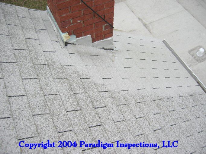

            As noted, probably lichen or moss.I use vegetation killer on mine; works better than bleach and H20.I haven't tried bleach and TSP; (I try to avoid mixing stroing chemicals.)Copper or zinc strips can work, but sometimes they don't work all of ther way down the roof surface Attached is a pic showing how copper can control lichen, from copper flashing on a chimney.

          6. MikeSmith | Jul 23, 2005 04:00am | #10
            pretty dramatic difference in the drip zone

            thank you for the photo, the copper really does make a difference
