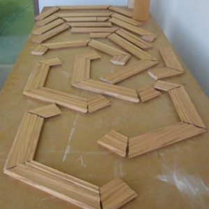

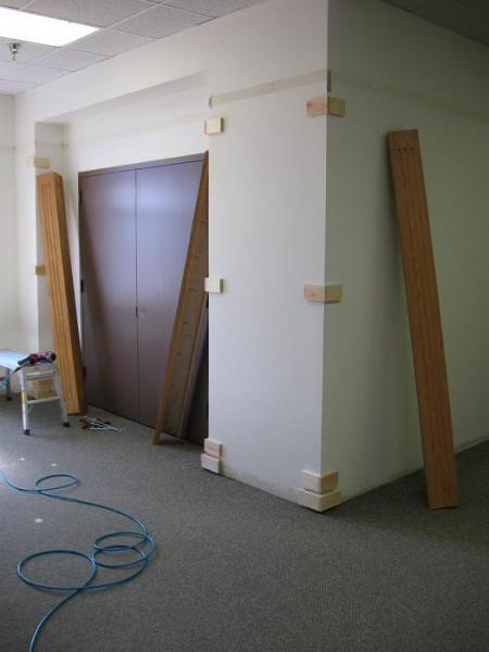

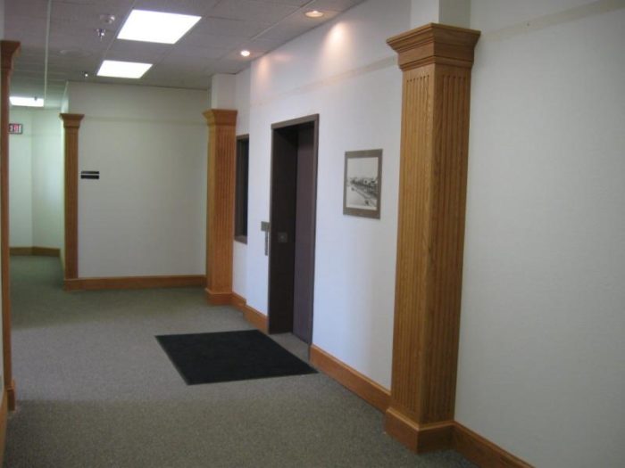

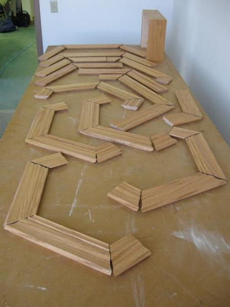

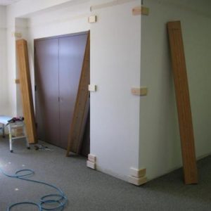

I’m now installing another dozen columns (technically pilasters… though many are overlays on actual structural columns) on the 4th floor of an office building. Next week I’ll do the bases, etc.

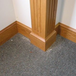

Here are some details for the outside corner work. Rather than just have the 1x flat on the wall, I added 7/8″ returns on the pilasters to give them more depth. This makes the pilasters look more “real” with the added depth and cutting the molding returns for the capitals and bases is easier (since they aren’t so small).
The 7/8″ added depth allows some play with 3/4″ nailers on the corners, scribing, and helps with out of square corners, etc.

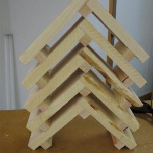

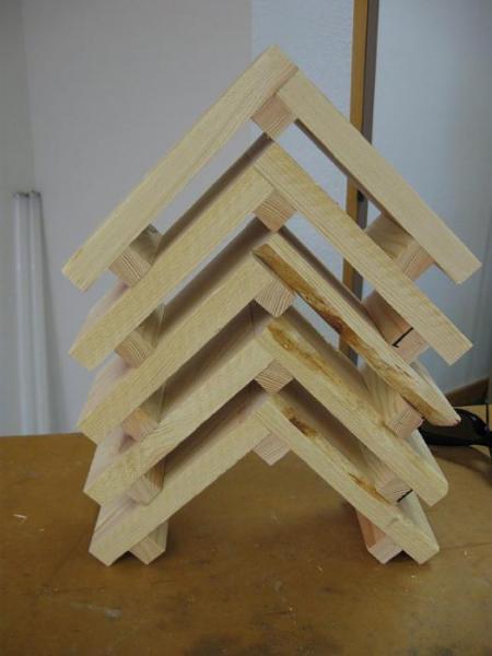

The base backing is 1x on cleats… just more easily adjusted or modified than solid 2x.

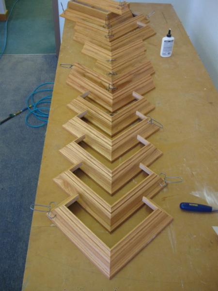

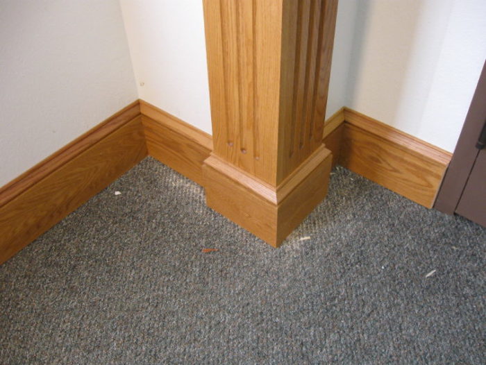

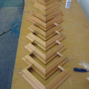

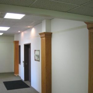

          basswood | Apr 17, 2009 04:22am | #11

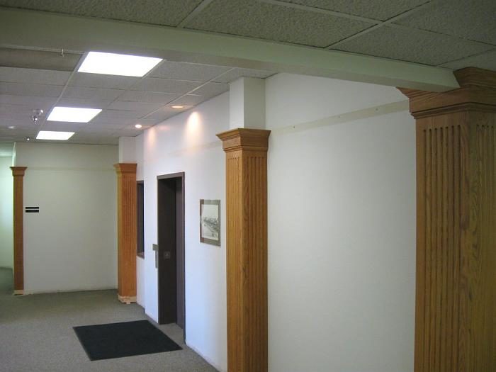

          Still working on this project... base and cap in now (160 pieces... Whew.)
          1. seeyou | Apr 17, 2009 06:43am | #12
            Looks fantastic, Brian.
            You know what kills me, though? All that great work and a foot above it is a dropped ceiling. http://www.quittintime.com/      View Image

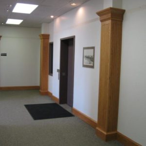

  2. runnerguy | Apr 12, 2009 01:03am | #4
    Nice work. Looking at that lind of stuff is always a feast for the eye.
    Probably not your doing at all but in the "main hall" photo, why wasn't there some kind of "beam" woodwork spanning the pilasters? My eye begs to have something sitting on your finely crafted top cornice pieces which now support nothing but air.
    But your craftsmanships great. Thanks for the photos!
    Runnerguy
      basswood | Apr 12, 2009 02:02am | #7
      There will be a "beam detail" of sorts... later in the week... so I'll post that too. Hopefully that will visually tie it all together.Thanks,Bass

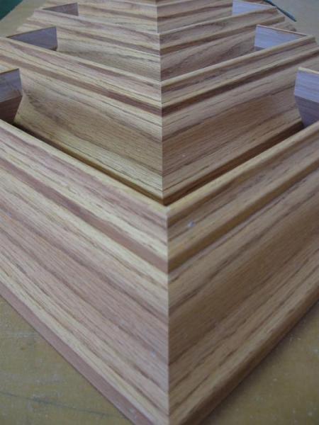

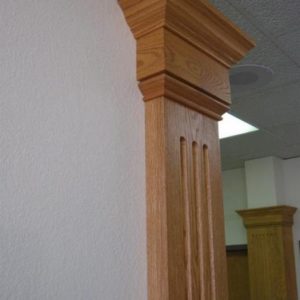

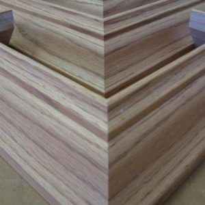

  3. Malo | Apr 12, 2009 01:15am | #5
    Now thats some clean mitering , real sweet work.
      basswood | Apr 12, 2009 02:04am | #8
      Thanks, I appreciate your compliments. I took that close-up because I thought it looked cool.
