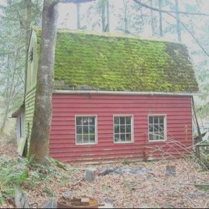

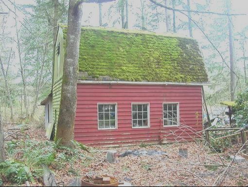

  5. junkhound | Jul 20, 2010 01:33pm | #5
    This on your house or barn??
    My barn (outside Seattle) has 3" thick covering of moss on both the 3/12 and mansard sides.  Barn is 35 years old, same roof, still does not leak, 3 tab asphalt roofing.
    After about 10 years the moss is so thick under the trees that you can grab a handfull and it all comes up in a big blanket, but most of it I've jsut let be.
