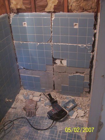

I’ve not done it with a diamond wheel; seems too out of control dusty! This is my preferred method

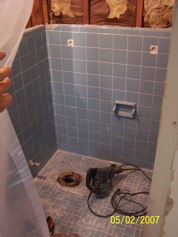

Room to be stripped
Cut into manageable sections with rota-hammer chisel –

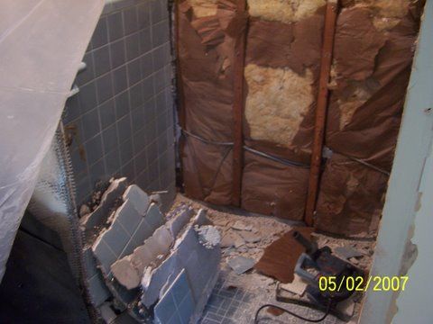

Fold each section down; rip wire mesh
Nice stack of 40-70 lb pieces to throw out the window

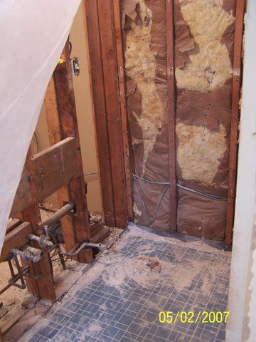

All gone

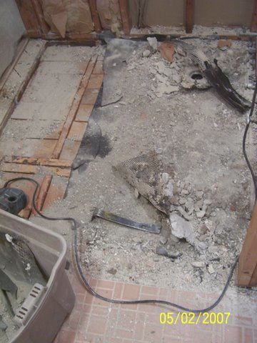

Floor is much the same, but fragments into smaller pieces
Empty floor; all 1x just lift out
