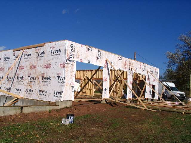

My buddy, the crane guy, has been talking about building a barn for as long as I can remember. He finally pulled the trigger and this is what we came up with.
The building is about 12,000 square feet. First floor is offices and parking for the cranes. Upstairs he is going to display his antiques collected over 35 years.
This is probably the scarriest building I’ve done. I couldn’t sleep the night before we lifted the gables and the trusses were a real adventure.

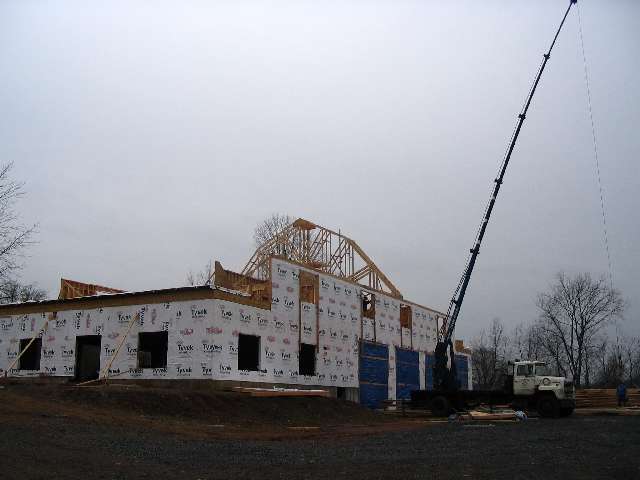

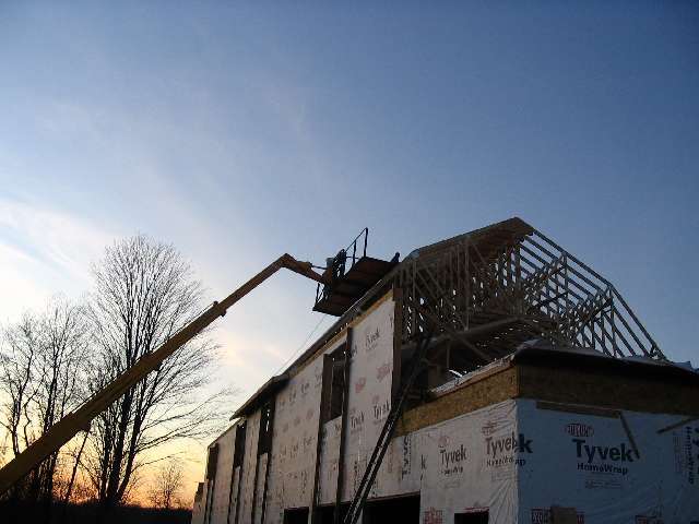

Looks like the trusses were field spliced? Doesn't look like much of a connection, but it's hard to tell from the pics.
Bosshog
You are correct they were field spliced, 10 -1/2" bolts and a lot of plywood and nails.The company that made these told my buddy these trusses would be stronger than a piggy back. I don't know if they are any stronger, but they were a pain field splicing a 50 x 21 foot truss.
I will say one thing about the company that built these trusses, they were consistent. These were designed as 50' trusses , but after we assembled them they ended up being all 50 feet 1/2", all 62 pieces.
This building took over 2000 feet of bracing for X bracing and lateral.I don't think I want to do another for a while.

I'm glad to hear that they were consistent. With something that big that has to be built cockeyed in the jig, it's awfully hard to get everything perfect.The story about field splices being stronger than a piggyback is BS. Either one would have to be designed for the same loading, so it wouldn't make any difference.

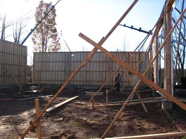

We poured 14 -36" sonotubes, and erected two steel beams 122' long. We drilled 300 1/2" holes in the steel beams to mount wood plates.

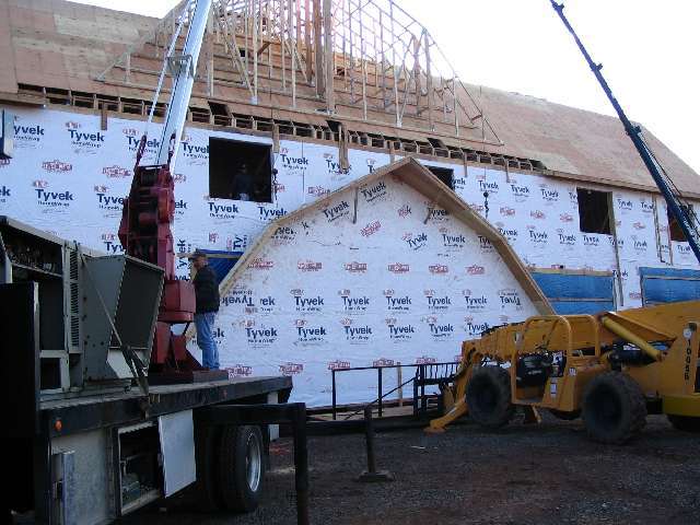

Al the 14' walls are 2 x 8 16" oc, everything else is 2 x 6 walls.The gable ends were built one shot, including overhangs, 50' x 29' tall.Probably not a good place to torture test your wall jacks or my proctors.All the walls on the first floor were set by crane. The largest being 50' x 14' -2 x 8 16" oc., heaviest wall we've ever built.
The roofers took four days to do 90 square.It would have taken us two weeks at least if I could summon up the courage.

I've flew in a few finished walls myself, so I can relate to a lot of the stuff I'm seeing. We would have taken a different approach on those 50x 29 gables though!

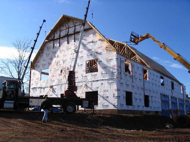

Nice lookin' but what the heck is the purpose of that dormer? Could have saved an awful lot of money if that's just for show, like it appears to be.
Jon
Yes the purpose of that dormer is just show, it was pretty ugly without it. Money had no bearing on this project, this is fulfillment of 35 years of dreaming.
