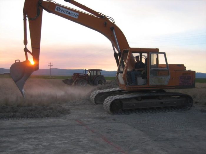

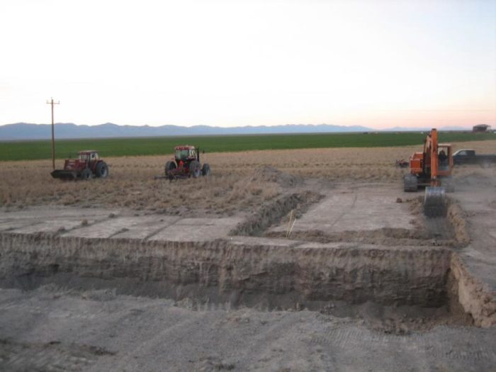

Getting a late start

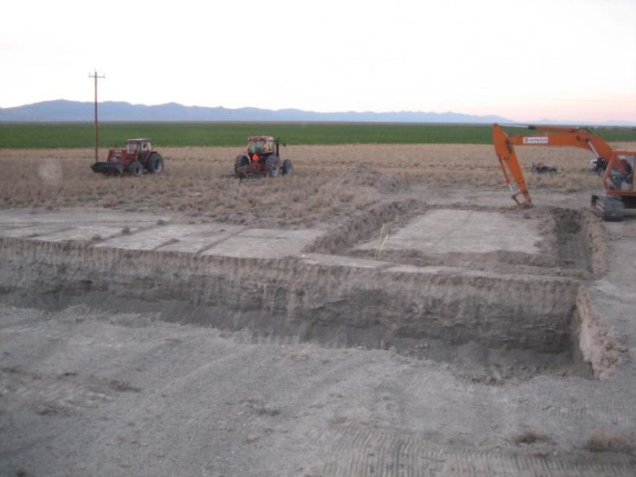

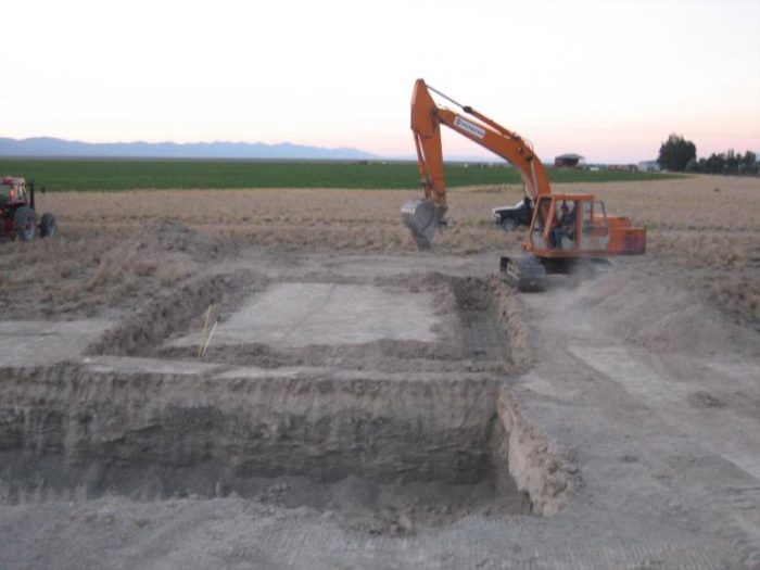

Two afternoons with the excavator

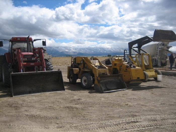

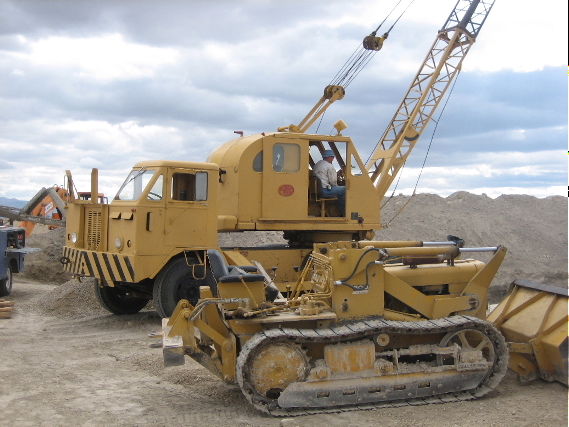

If you’re gonna run junk then you better have a lot of it

Too bad you don't have any scenic views from there ;)
Don

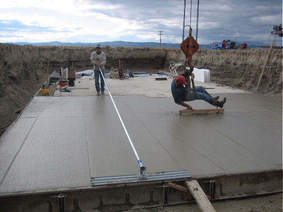

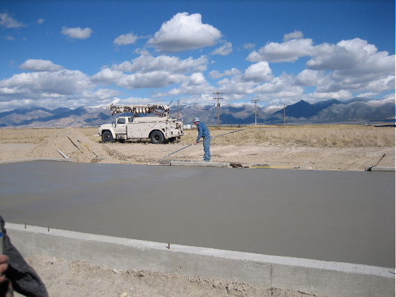

Garage slab -
More old iron -
Poor mans pumper truck -
Pulling chairs -

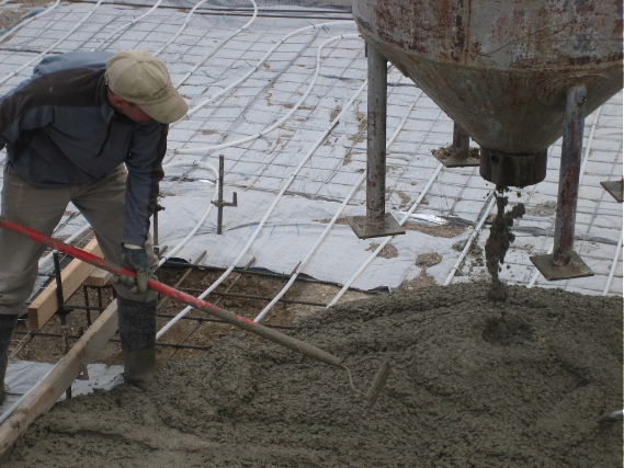

Real pumper truck for this job, 38yds in 3 hours! -View Image

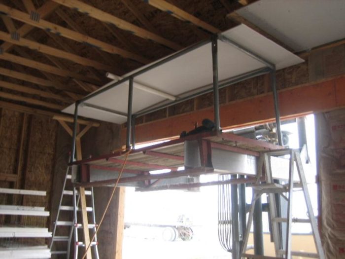

Couple more pics to share, then I need to go get more work done while the weather is so great.Anyone else use an 18000# capacity drywall lift?View Image

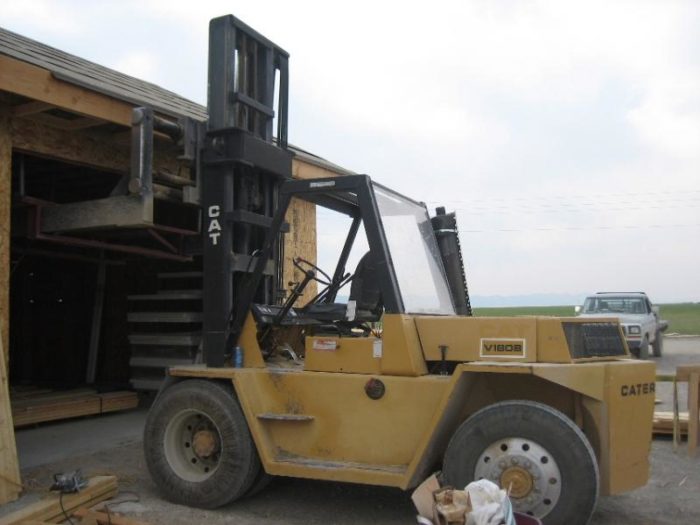

Cat forlklift + mancage = one man 12' ceiling drywall job, still wasn't any fun at all -View Image

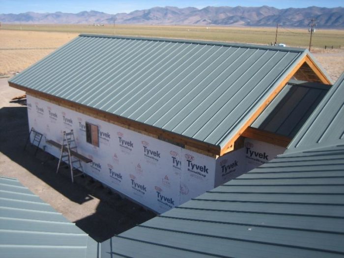

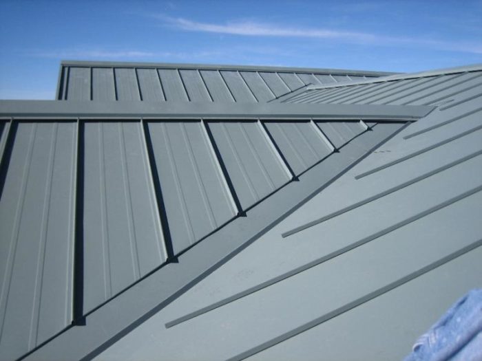

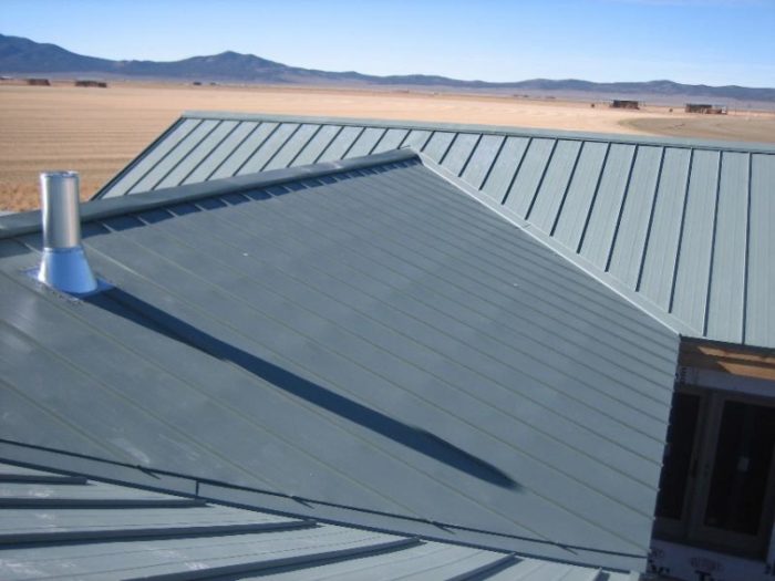

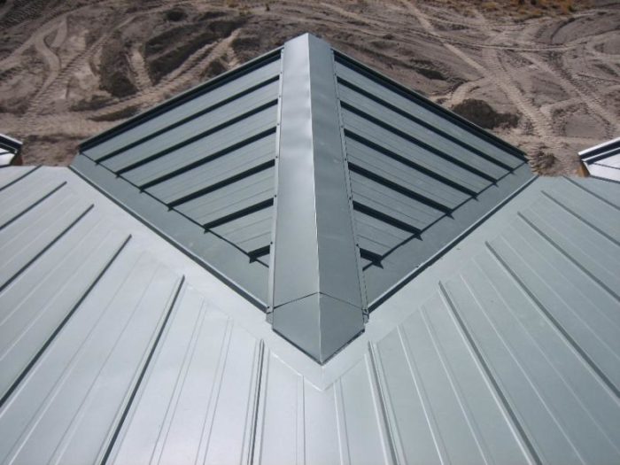

Finally got the rake trim and ridgecap on the roof. Vented ridge, Custom Bilt Last Time SL100 system with cleats holding the lower edges. Valleys were a little work but not too bad once we got going. Seems like a fairly bulletproof system, on a simpler roof it would be a piece of cake.
Center section of house is 4/12 -View Image
Bedroom wing, kitchen, and garage all 6/12 -View Image

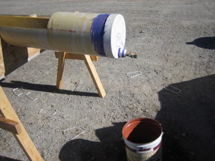

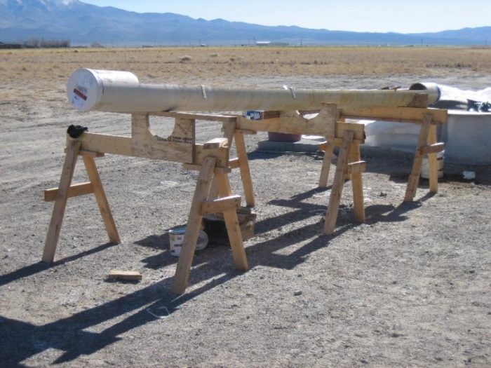

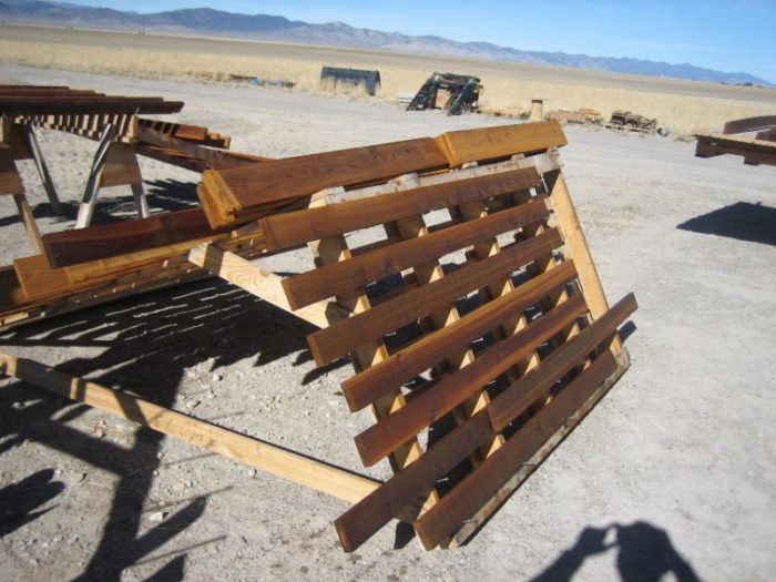

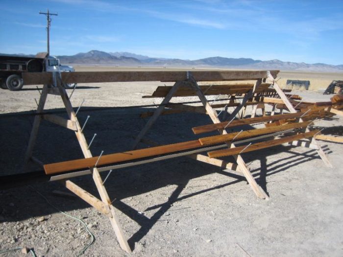

10"PVC dunk tank -View ImageView Image

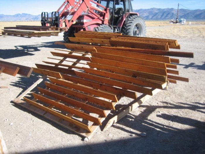

Drying racks made from whatever I can find laying around -View Image

I like the drying racks. jt8
