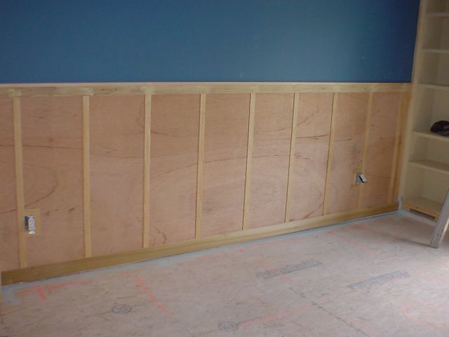

Beautiful work on the ceiling and floor. What is planned for the walls? Panels? Drywall? Plaster?
Mike here's a pic of the wall in the rough. The paneling is raw wood here, but it will be painted off-white like all the rest of the house trim.
Lifted the design from a Pottery Barn catalog. 1/4" luan ply, 1/4" x 1-1/2" battens (sold as screen lattice at a real lumber yard), all sitting on top of 1x4 poplar. The cap is 1x4 ripped, with 2-1/2" verticle with a 1-1/4" horizontal piece. Went up really easily. Battens are at 16" to match the studs. Top of the cap is about 46" off the floor, which happens to aliogn with a shelf.
The whole idea was to make it look like an old doctors office, or maybe an old universityt clasroom.
