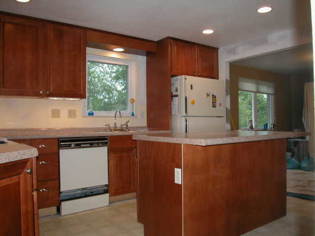

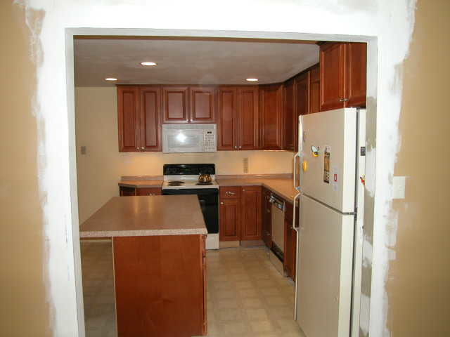

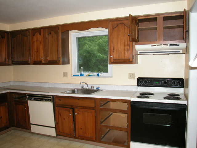

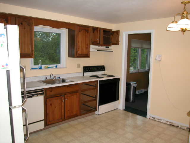

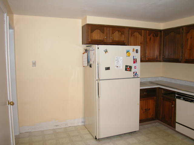

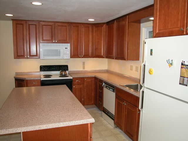

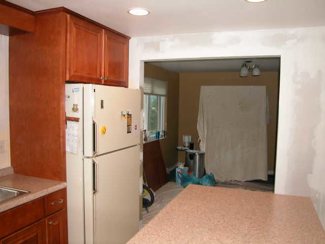

see if I can find the before an afters.
first kitchen job for a new dealer/designer.
came out nice.

Those before's are ugly!
Looks nice but couldn't you sell em a new floor? That yellow vinyl doesn't do your cabinet work any justice.

this was as a sub ... they had already contracted a local flooring place for their new floating floor. I dug deep into my own pocket and spent an extra $10 for some 5/8th osb to make the cab's level with the existing floor ... the old were buried.
it was my decison ... so I elected to go back after the floor is laid to run the base and associated trim. I had already priced in for such an occurance ... always makes for a nicer end result.
they threw me a cheaper kitchen for the first one ...
not that I mind cheaper ... as it all pays the same ...
just that I like the bigger more involved stuff. Though ... in and out ... paid fast .... no hassles ... might start liking them "cheaper" kitchens!
Still nice boxes ... just not a million dollar kitchen. And I had to remember how to set a PLam counter top! I've didn't realise how used to moving my tools so the granite guy can template ...
Kemper, I think the brand was ... not bad cab's at all. Nice all-plywood uppers ...

Nice clean looking work, Jeff. That kitchen is about my speed (you just finish it about 100X faster than I do). My budget doesn't allow for $50k kitchens, so I typically go for the most function that can be achieved for a reasonable cost. I typically don't pay the extra $$ for those microwave/exhaust-fans, but they can be a space saver.
And as long as it doesn't look dated, I have no problem with vinyl. Very user friendly and low maint. flooring.
Although... that island outlet kinda sticks out to my eye. ;)

Nice looking job.
Kemper makes three grades - cheapest is pretty cheap; mid grade and top grade are nice cabinets, plywood boxes and shelves, dovetailed drawers, decent hardware, etc. Your's are mid grade (cathedral door style gives it away).
I've set / hung a mess of them for local HfH.
I bought the mid-grade for my own kitchen and use it as a "show room" for prospective kitchen clients, most of whom are suffering from sticker shock," Why sure Mrs Jones we can supply the cabinets for only $XX,XXX......."

Is that really a microwave mounted just above the cooker?
John
John, they have been popular for several years now. It is a combo unit of microwave and exhaust vent. I think the one in Jeff's pics exhausts back into the kitchen (I HATE those!) not outdoors.
I've never used one because they tend to be more expensive (started around $600 last time I priced one) than a vent and a microwave would cost individually. As a comparison, I could buy a reasonable exhaust vent for $80-150, and a decent microwave for $100-ish. $250 vs $600.
"Someone's sitting in the shade today because someone planted a tree a long time ago." --Warren Buffett
that particular model is a top/rear/recirculate ... U have to pop the blower motor and direct the fan which ever way U wanna go.

Nice. Wher'd the soffit go? No mechanicals in it?
Always trust your cape.
http://www.hay98.com/
well ... that area above the sink "was supposed" to be open ...
most of the other mechanicals were hidden directly underneath where I was planning on running the wiring. I'm not kidding ... never ran into more problems trying to drill a few small holes ... duct work and plumbing ... everywhere I turned.
never did figure out where half of it ran.
