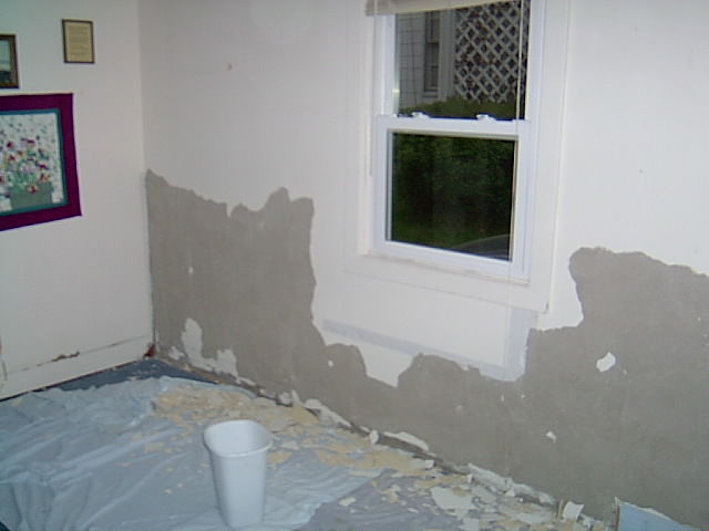

I started to scrape the loose plaster of the walls……………….
Mr T
Do not try this at home!
Mr T
I think you're going to need a bigger trash can, LOL.
The term "snowballing" comes to mind too.
Hey T,
1/4" sheetrock comes to mind over that mess.
Is it actual plaster over furring or is it rock?
If its plaster than I'd recommend a case of beer and patience.
Be patient and buzzed and dusk masked
Namaste
andy

Plaster over lath
I am just replacing the brown and finish coats with easy sand and lightweight joint compound.
1st spots I did looked good after 2 coats of each.

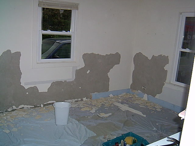

more pics will follyMr T
Hey T
In a lotof ways plaster over lathe is a lot easier than if it was rock peeling.
I'd look into using Structolite as my first coat.
I'll be doing a lot of the same so let me know how she goes.

Heres what it looks like after all day mudding, 3 batches of easy sand and one coat of lw mud.
dw supplier told me that easy sand would bond good if i wet the plaster first so the moisture wouldn't get pulled out before it set up.
the part I did 4 weeks ago seems to be holdin up fine.Mr T

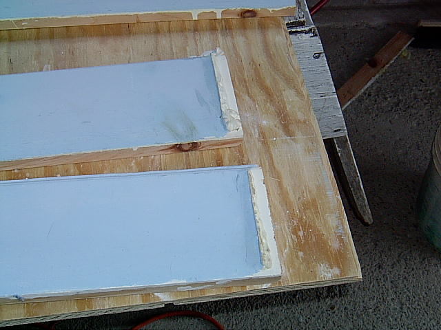

I don't know if you can tell but that is 1/4" of caulk that was filling a baseboard joint in a corner.
This guy was a real craftsman!!Mr T

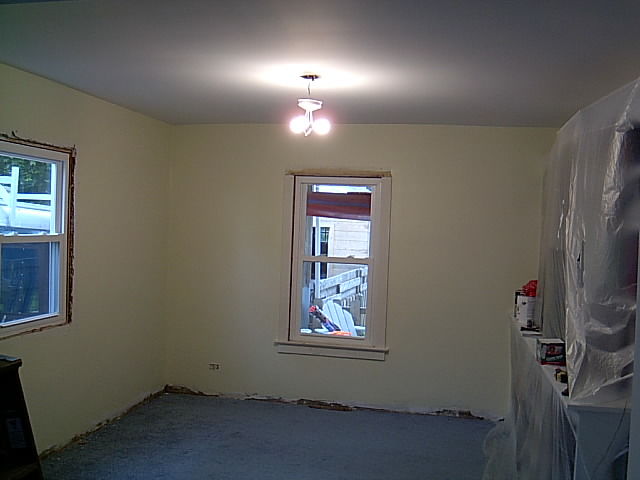

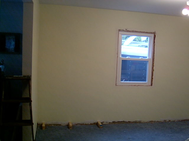

A couple 2-3 coats of mud and some paint and .....
VIOLA!!
1 More bookcase and some trim and some more paint.
and it's done!!!Mr T
