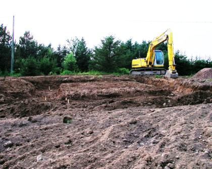

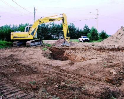

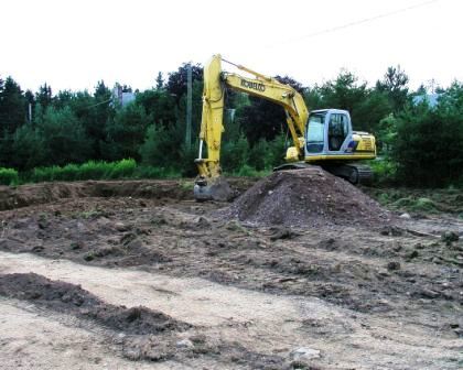

So far so good........Day 3 (aug-05-04)
day 4........
Hey Derick, thanks for sharing and keep em coming.
How about some more details, like how many square ft., and what kind of building
experience do you have. What do you plan on doing and what are you going to sub
out? Also when you have any problems, and trust me you will, come here with
them and you will be surprised at the wealth of info that is available.
Get some close ups of some of the building details like
rebar placement in your footing steps (I know it's to late know, but just for an
example) You'll appreciate the pictures later on when you try to remember how
something was done later on
Derrick , Looks great so far . Keep us informed. I would like to see the proggress.
Hello Butch and Bean
thanks for looking, well the house is 32'x52' with 30'x30' garage and a foyer(8.5' x 20') . The basement is 4' cement wall and 4'-2x6 stud wall. also basement is walk out in the back as the lot lends its self easily to this design. Anyway here are a few more pics with the forms removed. I hope I am geting better at pic posting, I think he first few were a little to small, then I made them so big that I could not even post them but now I think I have it........

Looks like you are ready for the foundation drainage system. Also looks like you are going to have a masonry veneer - is that on all sides? What area are you building the house in? (State/Providence)
The trick in GCing a house is to try to get as a seamless transition between subs as possible. In other words, get every sub to fully finish his job before he leaves (don't pay all until all is done and inspections are signed off), and try to set up the scope of work for each sub so little things won't get left. Here is a little example: Was building a house with a sewage ejection pump. Plumber said - not my job to hook up the float switch - that's electrical. Electrician said - not my job to hook up switch - that is low voltage so the plumber should hook it up... You can guess who ended up doing it - well, not actually me, but one of my punch-out guys. That was fine, but what about later, after the home owner moved in and the float switch had to be adjusted :-( Also, if you have to hold back money because something isn't completed - make it a significant amount. This also means that you have to have everything on site for a sub to do his job - or at least the materials that he is not responsible for supplying. Otherwise, all your time will be eaten up by fixing little things that were left and you won't have as much time as you wanted to peform the phases of construction you already have decided to do.
Keep the pics comming.... Matt
