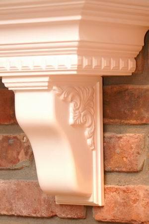

Well, I finally got a digital SLR. Been dying for one for the longest time. It came just in time too. I finally finished my living room.
Here is a pic of a mantel I built for my living room. Thanks to everyone here at Breaktime who helped…I had asked questions about clearance (from the flue for the stove) and how to mount it to the brick wall (2×4 lag bolted into studs behind brick, then mantel screwed thru the top with deck screws.
The mantel is ~76″ long. It is made from mdf crown trim, clear pine, and some decorative trim (the dental detail). The corbels are pine blocks with decorative scrollwork glued on the sides. The pine blocks were “enhanced” with some boards routed on my router table to give it a more beefed up look. They are glued and toe-screwed from behind into the bottom of the mantel. They are for show only and don’t support the mantel in anyway.

Here's a before pic of the room...it's actually a mid-renovation pic. You can see the brick surround and stove. The wainscoting was also up but not painted yet.I've also attached some closeup pics of the mantel.

I could have sworn those corbels would be plastic-based material, surprised to hear they are pine.
Very clean job, nice work!

Thanks all for the compliments. I couldn't have built this without all the knowledge I've gained here...from picking the right primer and paint to joinery. This site is a treasure chest of empowerment for us DIYer's. Those corbels were the toughest part. I walked around Lowes and my lumberyard for at least 2 hours looking at all the different options. I have to say, designing is almost as hard as building. Because of the dimensions of mantel, I couldn't go with any of the precast or premade stuff online. They were simply too big or too small. I did find some at Lowes that were the correct size but they were too intricate with carved grape leaves and all. It was too much for the simple, clean lines of the trim in the room.I'll try to get more detailed shots and more of the room. My wide angle zoom isn't working right with my digital camera right now. I'll see what I can do.
