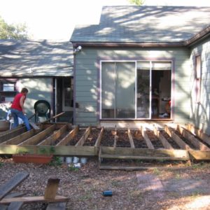

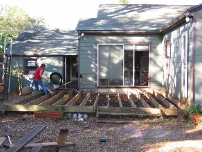

    I had begain to demo some things, siding, a deck, and I had to remove an old footer to lay the new footer 7 inches further out. I rent a J-hammer ($) and borrow a trailer and get to work.
    I hit this right were the new footer is to go:
    I lost some time, but pressed on.

    My buddy runs the new plumbing a little early because I put the jackhammer through the old clay sewer line.

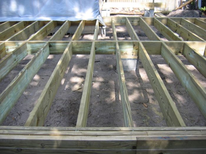

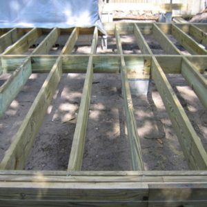

        Maybe I missed it ... why do you have four concrete block columns in the back?

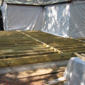

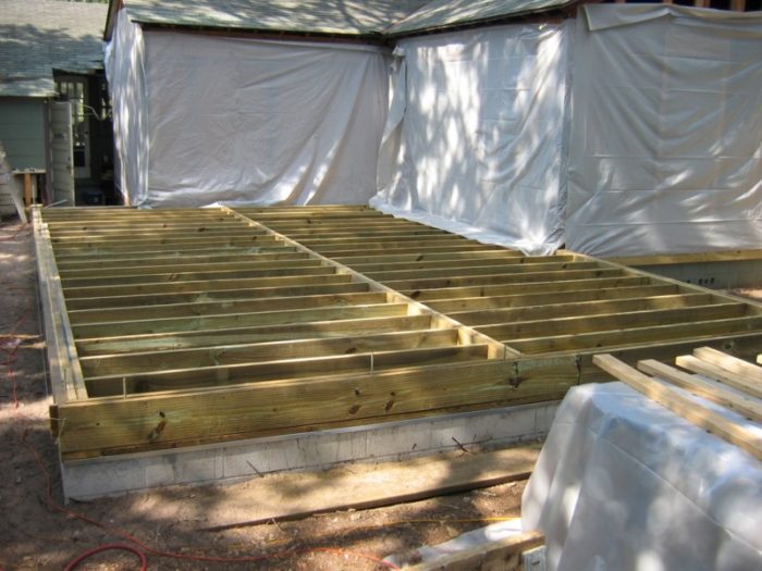

          Those are our piers. We'll run the floor joists off them hopping from one to the other with (3) 2x10's. I'll get a better ic for ya once we run the bands.

          1. FastEddie1 | Jul 29, 2005 12:25am | #15
            Those piers look a lot higher that the existing floor.

            Sailfish | Jul 29, 2005 03:09am | #17
            The piers are approx 12" below the current finished floor.
            Pics maybe Teusday of the joists-----------------------------------------------------------------------------

          Well here's the progress. We got the metal on, the sills, bands and floor joists on the 18x28 GR, tomorrow we strap, deck, and hopefully start the bathroom/closet joists off to the right of the picture.
          And if you look at the multi=paned glass door in the background, you will see my office. That where I try to work my regular job while doing the renovation project
