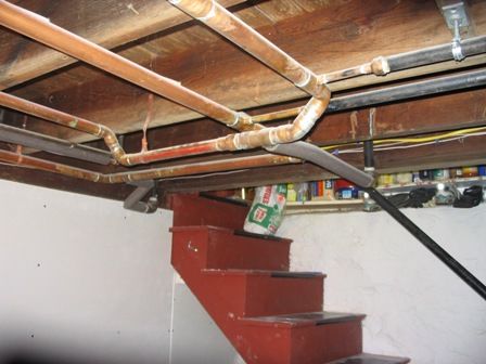

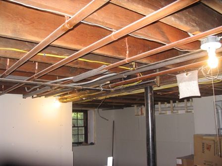

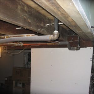

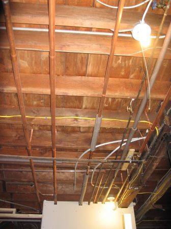

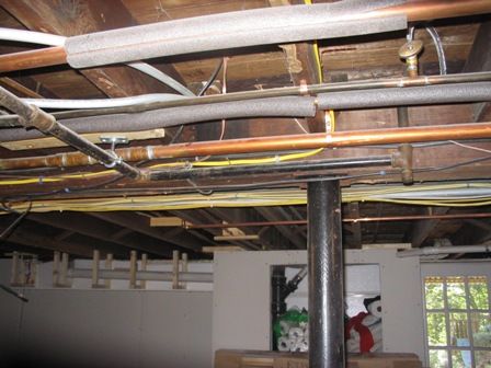

DIYer here looking for a bit of help from the experts again. Trying to figure out what I’m going to do with the basement ceiling (Joists are at 7′-2″). I laugh when I look at some of the basement remodels with their perfect bays and no pipes, valves, drains. Here is mine and I’m running into ceiling issues. I’m definitely going with a drop ceiling but I’m not sure how to incorporate some of these pipes. I’m thinking of a few soffits and tying the drop ceiling into these.

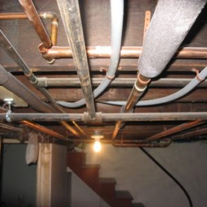

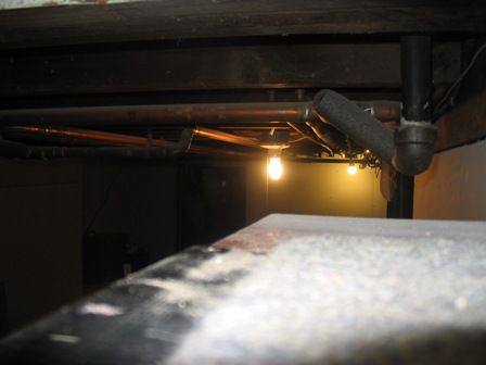

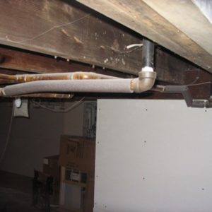

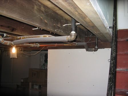

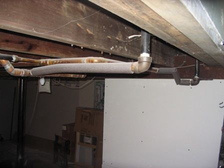

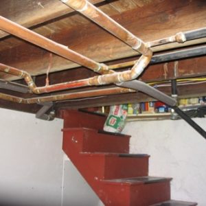

First problem area is the base of the stairs. I’ve got pipes extending down about 5-6 inches (you can see the pipes in the stair pics). Ideally I’d like the drop ceiling to tie into base of the main support beam (Height is 6′-10″). but a few pipes drop below that (down to 6′-10″ and 6′-8″). Because it’s near the stairs and I don’t want to reduce the headroom where you step down I’m thinking of a soffit it that spot. I’ve also considered letting the lowest pipe (6′-8″ one) just come through the drop ceiling so I can use the bottom of the main beam as the low point. Anyone have suggestions?

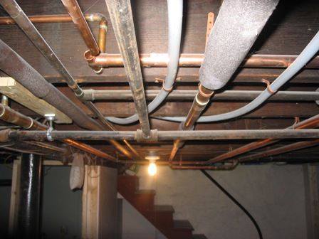

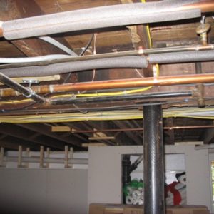

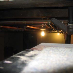

Second spot is the main gas line (6′-10″) which also is right at the level of the main support beam. I might be able to pull it up just enough but I’m not sure how I’d get the ceiling panel in even if I could do this. I put the brace in that is there, before the pipe was just resting on the main beam where it went over the beam. Another option is a second soffit around it. To go with all this you can see a that stub sticks below everything. (Is that a drain stub of some sort?, someone told me that was what it is for.

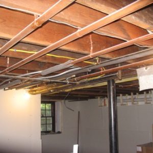

The back half has a lot more clearance other than this and 2 pipes near the rear door. Again possible soffit drop ceiling on each side of it?

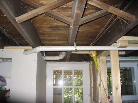

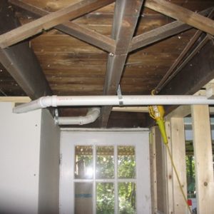

Fourth is the drain line near the back door. This one is almost definitely going t be a soffit. I plan a sheetrock ceiling when you first open the door. You may not be able to see it in the picture but there is just enough room for this over the door and under the pipe right near it. If you look in the bathroom (that’s the wall that is still open) I’ll probably have to build the wall above the window down a bit to tie the bathroom’s drop ceiling into it (other wise I’ll never clear the pipe further from the door).

    I'm assuming you're not getting a permit for this work, since the minimum ceiling requirement for habitable space is 7'-0".  That may come back to bite you if you ever go to sell the house.  You also need a minimum of 6'-8" clear above the stairs, so make sure anything you do there doesn't encroach below 6'-8".

        BTW- have you considered putting in a drywall ceiling tight to the joists?  Since most of your piping will be in soffits anyway, it's not like you need the accessability of the suspended ceiling, and the extra 3" or so of height will be a big plus in an already tight space.
        Bob
        1. Ribs | Sep 19, 2005 10:05pm | #6
          Thanks I hadn't heard that before (regarding the permits). As for the drywall ceiling there are also a number of shut off valves up in the ceiling that aren't visible in the pictures. I could do it but it would mean a ton more work figuring creative ways to get at those valves. That's part of the reason for the drop ceiling. The otehr is future work with regard to running wiring to the first floor.Tom

    Wow, that may be the most convoluted plumbing I've ever seen! I'd be thinking about tearing it out and running new in the joists. PEX could replace most of that copper. The drains are harder, because pitch dictates where they run. Maybe some could go in a stud wall? Given your ceiling height, I'd look hard at re-plumbing.

      Want to hear something funny. Those are the new pipes. The whole boiler was switched out last year during another construction project. Old pipes were like 4 inch cast iron (you can see them in some of these older pics). House is forced hot water (Now, was gravity). Separate feed and return on every radiator. I actually thought they did a good job getting them closer to the ceiling then the old ones were.Replumbing is definitely cost prohibitive. Translation I can't do it so it's cost prohibitive. Someone is coming in to put in a new zone for the basement and connect the radiators but that's the extent of outside plumbing planned.Like I said this is why I often find basement articles amusing (after working on this one). I liked yours for it's information but they often completely disregard the fact that old basements aren't as simple as new ones. You can see some of the new walls in the pic from Jan. Those are mostly sheetrocked now. Next project is the floor then the ceiling so I'm trying to work out the kinks for that part now.So what do you think on the soffits?
