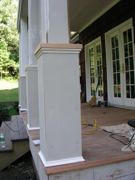

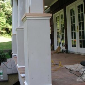

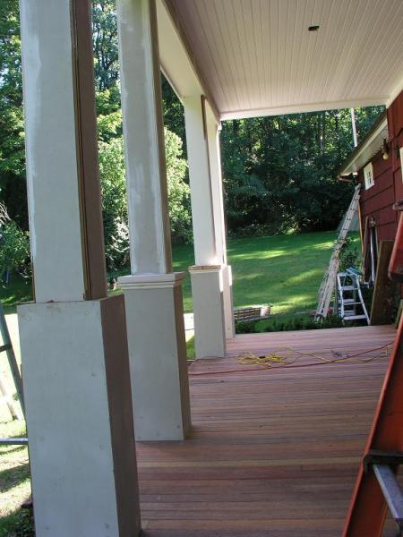

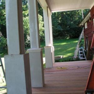

        Thanks to everyone.  I have decided to go with a red oak stain to darken the flooring so that it matches the original stained and varnished ceiling of 80+ years ago.
        I applied the first coat of varnish today, going on the recommendation of my local hardware guy (they also own a lumberyard across town that I deal woth regularly).  it is an exterior varnish with UV inhibitors (the name escapes me at the moment).  also, the porch floor is protected by a roof and walls on two sides.  Very little exposure to elements (sun included).
        It looks absolutley beautiful so far.  Will return on Wednesday to add another coat.
        The porch is not used... no steps up to it and door from inside is blocked.  BUT it is the roof over that section of basement and the previously leaking arrangement was "fixed" by another "contractor" and leaked even worse at his completion.
        Here are some pics of the porch floor before I started and up to today's progress.  I am terrible at taking photos like I should but I am fortunate enough to have a client that does and also that he does web design so he has them online already.
        The floor looks extra shiny in the shots because it wasn't dry yet today when he took them.
        the pics are here>>>>>>  http://www.boom-creative.com/porch/
