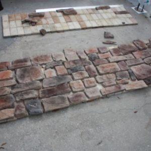

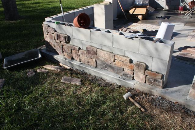

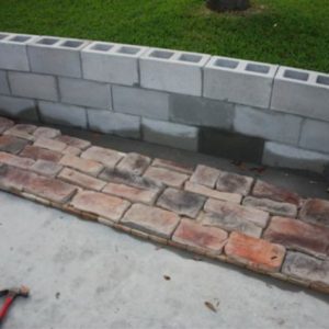

Hi,
I’m have trouble setting out some stone veneer. I losing my way from the floor set up to actually getting it on the wall. Needless to say one wrong piece throws everything out. I’m hoping to get some tips and tricks on doing this job, which I’ve never done before.
All help appreciated,
Mike

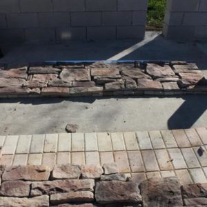

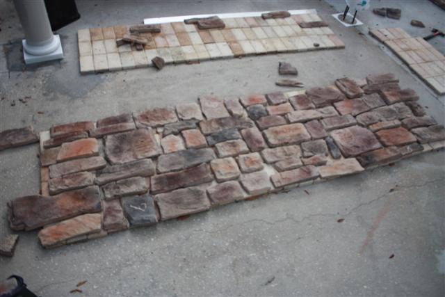

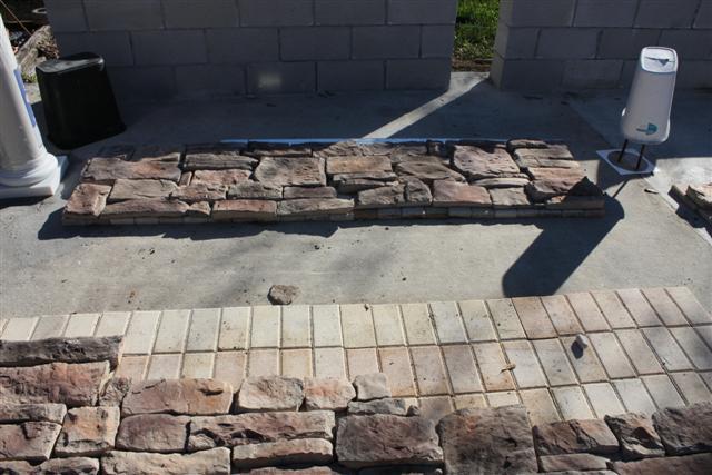

Sorry, forgot to include the pics. Thought they may help.
Mike
First off, wet the block as you go. Your mud will dry slower and stronger. Facing a wall like this is an attempt to mimic a "Real" stone wall.
So, think in terms of "Courses".
They don't have to be linear like a brick wall, but rather layer upon layer as you would if truly stacking stones.
I think your stones don't have a feeling of "Sitting Down". Or being
weighted down if that makes sense. Started with the corners. Build both the face and the end together.
Keep in mind you will want to cross the joints next to the corners as much as possible.
This is a often obvious detail with facing. You can see a vertical line running next to the corner. As you lay on layer you are leaving a negative space for the next
course. Pay close attention to the space you are creating for this next stone.
Big steps and unfillable voids will have you looking for
"The Perfect Stone".
You are working with very regular squares and rectangles, so
make Squares and rectangles that suite them. All of this goes contrary to laying out the entire wall on the ground.
Don't do that. It won't fit right and it won't look good either. Loosen up!
This a creative task and requires a clear and confident mind.
As long as I'm rattling on... Striking the joints is it's own deal. Work with rather dry mud (not old mud but dry mud).
Pack the joints full so there are no voids hidden inside.
Let it set up. that means waiting for it to no long smear
on the the face of the stone. Then compress it back. At this point there are numerous ways to finish the look.
I "Strike" my joints. Which means as I compress the mud I also scrape it back to
an even plane.
Usually a 1/4 to a 1/2 inch back from the rock face. Then wait again. When it is just barely workable I brush each and every joint
smooth.
One of those throw away china brushes is perfect. Hope this was helpful. Chuck

The stones are very irregular, a bit too "natural" The problem I'm having is that some of the shapes are bit bizarre, like natural stone, however, unlike natural stone trimming and cutting the veneer spoils the whole effect. I'm going to try one more wall, this time leaving space for a grout joint. If it doesn't look better I'll switch the stone out for something a little more symmetrical to use on the inside of the walls. That's what will be the most visual. I think I'm over my head here.
Thanks again,
Mike
From your last post and looking at the pictures, I think maybe you
are trying to lay them to tight. Those stones aren't meant for a "DryStack" look. As in no visible joints.
Your wall will have the stones "Floating" in the joints.
Now obviously if the joints are to big it will look crummy, but
making them to tight is no good either.
What happens is you end up with big gaps where the profiles don't match next to tight little joints. Not good. Start a bit loose and then stay consistent. Do you have a couple of these-
http://www.toolbarn.com/category/masonry-tuck-pointers/ Get yourself a couple. one that is 1/2" wide and another 3/8". Use the 3/8" as your guide. That is ideally what all your joints should be.
1/2" takes care of the wide spots. Avoid narrower then 3/8" and it will look fairly consistent.PS
You really need some corner stones.
Edited 1/11/2009 12:49 pm ET by Henley

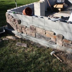

You were right. I gave a bit of space between the stones and, which seemed to make things much easier, started from the middle of the setup and worked my way out. Spiral fashion. Still need to do a little finalizing but all in all it went much better. Did the 2 setups pictured in 15 mins. The last 2 took me 2 hours. I'm learning. Thanks to all the other helpers. I can't tell you how frustrated I was getting.
Mike

What's the problem again? The only thing i can see is you didn't use corner stones everything else looks fine.
Remember the rule.........2 stones over 1, 1 stone over 2.
Do the corners first, pick the best outside edges for them.
Once the corners are up, run string line across the faces to keep the wall going vertical.
I always try to think 3 or 4 stones ahead, ie.........if I put this here, what will that do for me there.
Trim your stones to fit........don't leave a little 2" x 2" square hole to fill .............it doesn't look right.
Try to keep your joints away from each other.......too close together results in odd spaces.
My first wall I built I spent 2 long hard days doing it. Third day I spent tearing it all out. That was 28 years ago. Haven't torn one out since.
Do it right the first time is my motto now!
Rod

OK I see your fundamental problem. You're trying to lay stone like brick.. It's not brick and shouldn't be treated like it is..
Laying stone is more art than science. Let the stone talk to you.
I know how mystic that sounds but please it is really simple once you understand it..
Accept that you're going to put up several stones before you find the"right" one for a given location.. with experiance your eye figures it out like the pieces of a puzzle and you'll look at stone and it will just tell you where it goes..
I started with what are called slip sticks.. when a tape measure breaks it's end off cut the remains with a tin snips at exactly the 1 foot mark.. use that to find a piece about the right length and depth.. eventually with experiance you'll glace at stones and pick the right one up every time..
