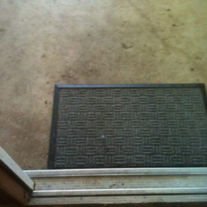

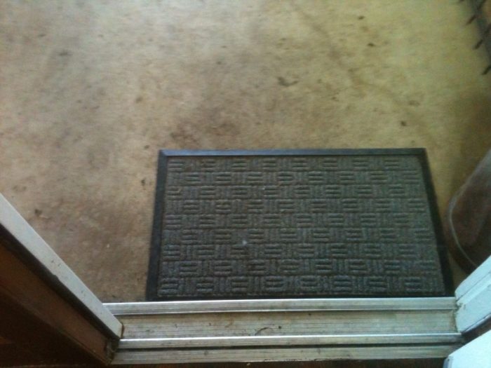

      What we are planning is to use the 8 x 8 area as part of the living area and just move the door out further. There is Hardy board there now and we will tear it down and put up drywall and hopefullly put in handscraped oak flooring to match the rest of the living room but we were not sure how to deal with the difference in height. I was told if there is a thin layer of concrete it could break and didnt know if the 3.5 inches is thick enough and was worried if I just built up the floor with plywood and using a vapor barrier of some sort was enough protection, I attached a photo from outside on the patio looking at the door that enters into living room.

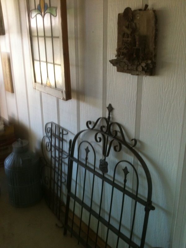

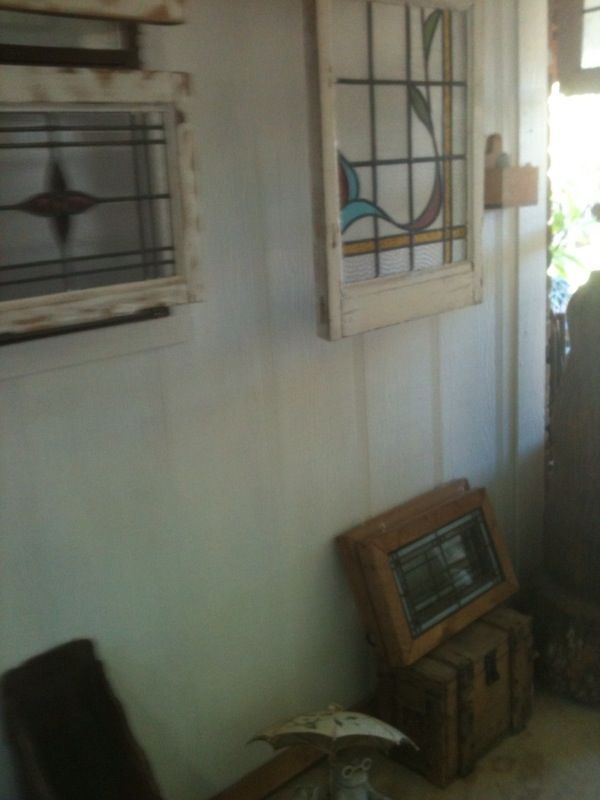

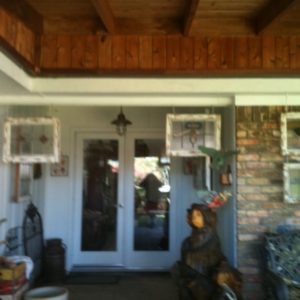

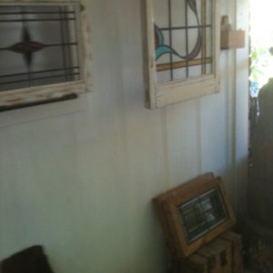

            I took some pictures looking out of the back door to the patio and then looking from the backyard to the back door

            OK, am I thinking correctly now............
            that you are moving the door not far-out to that brick wall / below where that dark ceiling starts?
            If the slab doesn't move, isn't cracked I suppose you could do either of what you intend.  Your wall holding the door isn't going to be taking on any load from above, if it's stable below.........shouldn't be a problem.
            I might (if the new step down to the patio ((if there is one now)) isn't going to be too tall), cut sleepers to even up the floor with what's inside, run a "plate across the whole opening (that is flush with the sleepers/int. floor framing).  Foam insulation between the sleepers (to keep the cold slab from cooling the new interior floor.  Make all your sleepers etc in contact with the concrete-treated.  Install plywood subfloor.  Set the door on that (shimmed up if your interior finish dictates it (throw rug/whatever).  No need for another plate under that door threshold.
