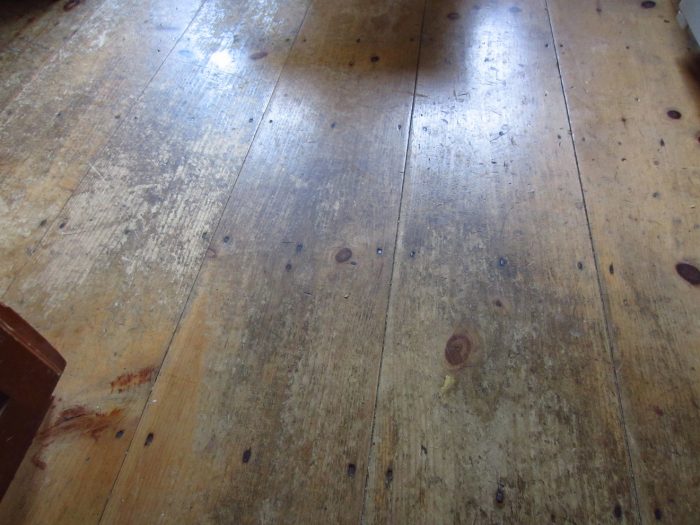

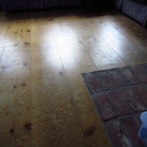

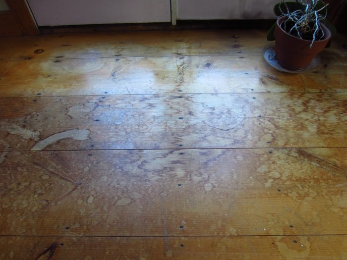

I’ve recently moved into a home with nice pine floors that are in bad condition. I don’t know how they were originally finished or what has been used on them since. They’re 20 years old. I’d like to protect them from further damage now and try to restore them in the future. We heat with wood and must tramp across them to the fireplace with wet or snowy boots throughout the winter now, so until that changes I want just to protect them from further damage, especially from water. I would be glad for suggestions of a product or type of product I could use that would not hinder a future restoration. I’m attaching 3 photos. Many thanks!

Shovel the snow to the pile of wood so you can use slip on shoes to get to it. Get a big enough mat that doesn’t allow moisture to get to the floor and leave your wet foot ware on it. Stomp the snow and debris on that mat. Heck, get a bench or stool by the door.
The orchid and other plants, keep them on a tray that doesn’t allow moisture through to the floor. It’ll also catch the excess when you over water.
Area rugs to hide the ugly parts and runners to get you to the fireplace.
You probably won’t get the dents out sanding it down, and maybe not lose the water marks from the neglect of time. When comes time, learn to use a floor sander or hire a well respected finisher. Not easy and a bad job finishing can further screw up what you are trying to improve. There are good finishes available, both very low and short lived aroma waterborne as well as strong smelling urethanes if you can seal off and leave while doing it.
Best of luck!
Follow Calvin's suggestions for sure, but why not clean the floor as best you can and throw a coat of whatever clear finish you have on top of it now to protect the wood. When you refinish the floor you will be stripping down to bare wood anyway so the new coat is there just for short term protection. It probably will not be well bonded but it should do the job until you get back for the proper restoration later on.
Thank you, Calvin and Sawdust Steve. Calvin, those are good, practical suggestions. I try, but this is a small, camp-like home, with an unprotected entrance, and the outdoors WILL get in. I'm afraid that rugs would just hold any wetness next to the floor. I need to make the floor waterproof. The appearance doesn't bother me for now. I just don't want it to get any worse. Steve, when I have tried to clean the floor, even gently, there's just bare wood under the dirt. The original protection is gone in those areas. I like your suggestion to apply a clear finish. I don't know what was used originally. As you say, it will be removed when the floor is refinished. But what product could I apply to bare wood? I have another question: when the time comes to sand the floor, will the sander be able to handle the reproduction square nails that fasten the boards down? Thanks again.
4' x 8' x 1/8" masonite. Tape seams with Ramboard tape (4"). Be sure to vacuum floor before laying sheets of masonite down, otherwise any debris will compress into the pine floor.
FYI - Pine floors are VERY soft and a bear to sand because they gum up the paper really fast. Make sure you get someone who refinishes a lot of pine floors to do the refinishing.
Hope this helps,
Frankie
They look like every 20-year-old pine floor I've ever seen. They don't need any protection as anything you do will be canceled out by refinishing in the future. Even refinishing won't make them look perfect and just as soon as you start using them they will look pretty much like they do now.
If you're bound and determined to do something I'd wash them down good with soap, wipe them dry, maybe hit it lightly with a pad sander and 200 grit paper and then brush on a coat of poly. Pine floors are soft but still wear well. Nothing you do will make them look like oak.
Your life will be much easier if you could learn to appreciate the worn "damaged" floor. It's reality, not what wall street has sold us on as what life requires. If you take the suggestion to scuff sand and recoat it will still be easy to clean. Treated as such the floor might have to be replaced in as little as a hundred years, or more. To keep it looking continually new is a life complicating treadmill. IMHOP.
X2 on learning to appreciate the “character”. I would suggest a coat of shellac. I use Zinsser seal coat. It sticks to anything, it’s cheap and it’s easy to apply. Also, it dries in about 10 minutes.
