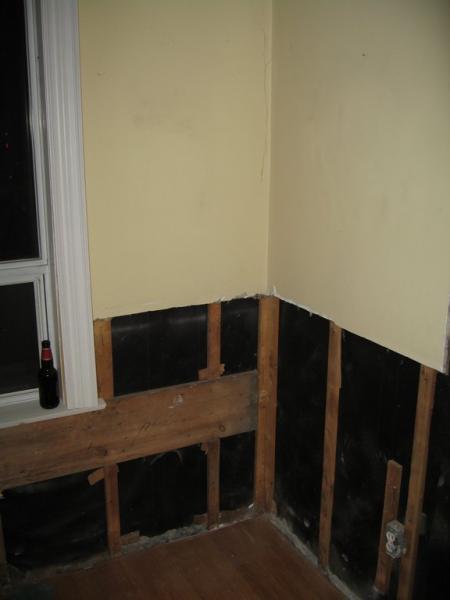

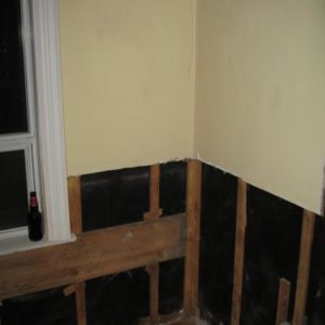

Hi,
I have a 1950 house with double masonary exterior walls. I am installing wainscott wood panelling in my living room and have removed the bottom 3′ of rock board and plaster around the whole room. There are vertical 3/4″ strapping strips 16″ on center on the masonary walls. There is no insulation on these walls with the exception of layer of a tar paper type barrier between the strapping and the masonary.
Before I put the wood wainscott on, I would like to add some insulation between the strapping. As I mentioned, I only have 3/4″ inches to work with, so my options are limited. I originally considered the foil coated bubble wrap insulation, but after reading the reviews here, I now not so sure of that…it’s also damn expensive.
Can anyone please offer any suggestions?
Thanks very much in advance.
Bill
(See attached photo)

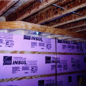

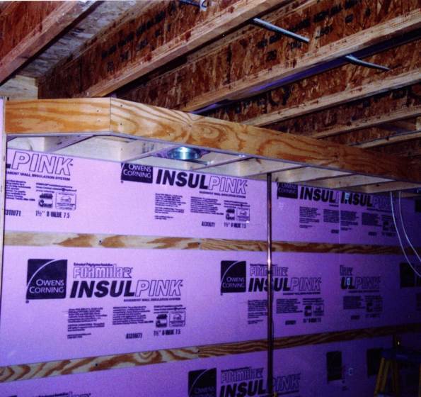

        When cutting foamboard, I undersize it some to speed up the process, then spay foam any gaps.The stuff for 16" OC firring that I found was styro (EPS) vs. XPS or polyiso, but it was a full 3/4" IIRC. It does take 3/4" of EPS to equal the R-value of 1/2" polyiso.This is how I like to insulate over cement block or concrete, with 1-1/2" XPS with an R-7.5 rating. The channels for the firring are molded into the 2'x8' sheets so the firring is isolated from the potentially moist masonry. The 3/4" of XPS behind the firring also reduces thermal bridging. I make my own 1x3's out of 3/4" plywood. Same $ and nice and straight.

            basswood | May 17, 2006 04:22am | #21
            I think cabinets over drywall/inulpink&firring/brick would work fine. I've hung cabinets in ICF houses over drywall and into the plastic mounting clips in EPS over concrete.On our Insulpink projects, the firring strips we used were 1x3's ripped out of 3/4" BC plywood. The firring strips were glued and screwed (with PL300 and tapcons). We apply the PL300 generously to the masonry in dabs, put a 2" rip of 3/4" XPS pressed into a bead of PL300 on floor at the base of the wall.Then run another bead of PL300 on top of the rip and press the first full 2x8' panel into the glue on top of the rip. Keep adding full panels & 1x3's on up the wall (more about the top panel later if you want the details). The extra rip on the bottom of the assembly allows us to use full 1x3's on the bottom of the wall for a baseboard nailer.That is how we insulate a standard masonry wall. Plenty of PL300 and tapcons every 16" on the firring. With soft brick, I might try every 12" and fine tune the pilot hole size for a good grab and don't overdrive and strip it out.For a cabinet wall, we would add a larger 10" rip of an 1-1/2" InsulPink panel as a starter course so that a 1x3 firring strip was centered about 34" off the floor (for attaching base cabinets) and firring strips would land centered at 58 and 82" off the floor for anchoring near the bottom and top of common wall cabinets.Once the PL300 sets up, the panels are firmly attached to the masonry, to the floor, adjacent panels, and to the firring strips. The system is very sturdy and virtually air tight.Also we use PL300 liberally when installing drywall to the XPS and firring. I would hang cabinets on the InsulPink system, as long as it is installed well...no problem.More tips later, if you are still interested.
