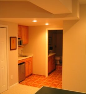

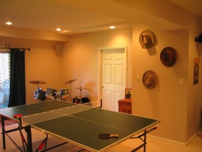

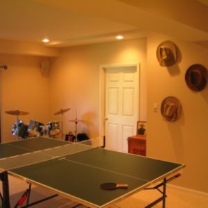

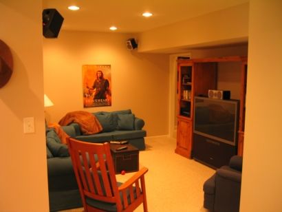

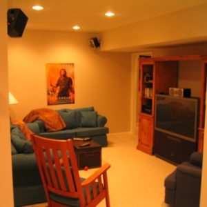

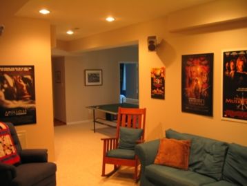

I need to dig up the “before” pictures, but here is a basement I did recently.
It had a very low dropped celing when I started, about 7′ or as low as the lowest sofit in the pictures.  To make matters worse the bathroom floor was raised to accomodate the plumbing, but they extended the platfrom all the way out past the bathroom door and made a weird little landing in front of the door.  I had to stoop down to get in the bath.  The whole space was pretty awful.
  With the excetpion of the bedroom walls, I tore everything out and started from scratch. I had to move all the duct work to the edges of the walls and rerout alot of electrical work, (since they had a dropped ceiling it was strung up like a bunch of spagetti) They also had the entire basement on one circut.
  I enlarged the office and changed the layout of the two main rooms. I also wired and installed the entertainment system.  I completly re-did the bath. The funky platform they had installed didn’t have any support and the toilet had leaked and rotted out the subfloor.
  Lots of soffit work, it looks a bit like I bad sci fi set, but the family is very happy with the new space, and they spend a lot of time down there. They say that it’s now the most popular room in the house.
