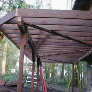

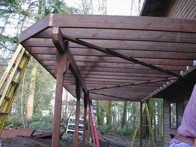

      1. rickchem | Apr 14, 2003 06:49am | #32
        Nice pictures!
        I saw that 2x4 bracing underneath the deck, on the joist underside, to stiffen it up - how do you set that up with 2 beams?  The deck I'm working on- I'm going off a cantilevered overhang, so I have a beam at 2' out, and another at 12' out - just a "W" pattern in between the two beams?  At the same time, it looks like you lagged the diagonal beam to post bracing - with a built up 2x beam, would the 1/2 lag into the 2 members of the beam weaken them (asumming a few inches penetration. . .)?  I've always wondered what a lag bolt does to the wood strength of 2x when bolted into the narrow of the board. . .
          ProDek | Apr 14, 2003 07:26am | #33
          I would thru bolt a rabbited 4x4 knee brace if I was using a double 2x beam. I would also notch the post the 2X beams rest on so all the weight of the deck is not just shear weight on the bolts.Bob
