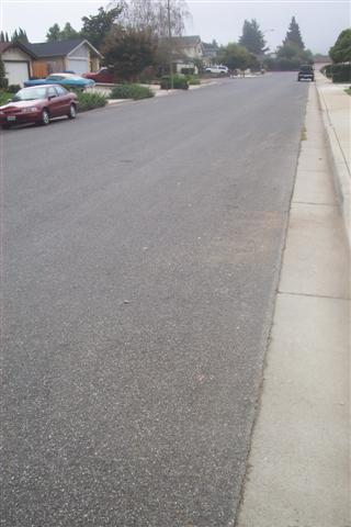

  16. Dave45 | Oct 23, 2005 08:16pm | #28
    I have no idea of how well this would work in Maine, but here in California they use a tar and screening process to maintain residential streets.
    Basically, they repair potholes and cracks then spray a light coat of tar followed immediately with a layer of fine gravel.  It gets rolled to bind the gravel into the tar and normal traffic finishes the rolling.  After a week or so, they come back and sweep up the loose gravel.
    These pictures are of my street which was resurfaced about three years ago.
    1. fluffy | Oct 23, 2005 08:30pm | #29
      Thanks, Dave45, the photographs really help. I think the closest thing we have to the California technique you describe is chip seal, which looks better than asphalt and behaves better than gravel when it's plowed - it may be my compromise solution.
      I've been reading about PolyPavement which sounded perfect on the website, but isn't getting good reviews in the northeast. Has anybody up here ever used it?
      1. Dave45 | Oct 25, 2005 06:01am | #31
        I think I've heard it called chip seal, too.  Around here, they use white gravel but I suspect that you could use other colors - maybe even a mixture - to get something that doesn't look "new".
        We don't have snow around here (well, not since 1976), but the surface is hard and would probably stand up to snow removal.
