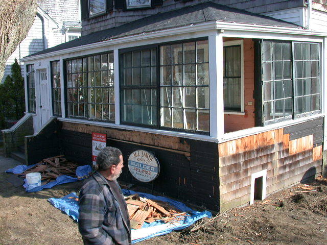

here’s a job Barry got , that we designed… so Joint Venture time…
take the shrubs down…. demo the glassed-in porch… jack and shore the roof.. and rebuild the lower portion…
managed to get our Andersen window order in for custom & van pricing and should have them in 3+ weeks…
here’s some of the progress…
here's some pics from today.. finally getting some nice weather..
jacking & shoring.... using our building screw jacks a building mover gave me 30 years ago when he retired..
and Barry with his Job Sign...
this building is a little peculiar.. some of the 2d floor cantilevers over the glassed-in porch.. so we had to jack and shore a little more carefully than we would with just a plain covered porch structure....
here you can see some of the cantilever...Mike Smith Rhode Island : Design / Build / Repair / Restore

Mike, is that a dog door or an access hole in the lower siding of that porch? I know I wouldn't fit in that spider hole.............
By the pictures of the walls I'd say this porch was overdue for a repair.........
yes.. access hole... found a real nice flashlight inside...but no other treasuresMike Smith Rhode Island : Design / Build / Repair / Restore
LOL - The flashlight was left behind by someone running for their life from claustrophobia and spider bites...................."Rather be a hammer than a nail"
