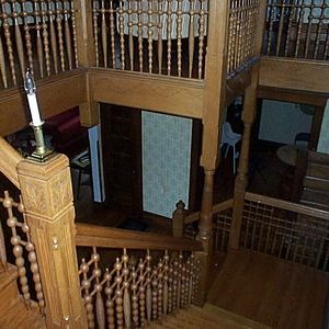

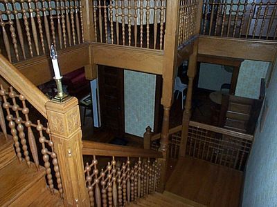

  13. pickings | Jan 09, 2007 06:28am | #26
    My first house was a brand new townhouse built in 1987.
    My second house was a 1955 split level in a development.
    My current house is an 1852 Greek Revival in the country.
    I have worked on all of these houses, and I can tell you one thing for sure......
    I have stepped up drastically in quality every time......
    Does this answer your question?
    PS... Only downside is that at this rate I will probably retire in a teepee.....or a cave.

    Some folks are happy to live a box lined up in row of like boxes. Other folks need more. I'm an old house guy, so I could never buy a house built by a high volume builder.
    I just put a large 2 Story addition on the back of my 1890's house. about 600 square feet. We put in a new Kitchen, added a Family Room, and added a second Bathroom and 2nd floor laundry. Our original budget was $100K and it just grew and grew. We ended up going up to $160K for the addition and renovation. Price included some deferred maintenance like a complete roof tearoff and replacing the original waste line to the street, So the actual cost of the addition was about $125K, or around $200/SF. Since we have some very large older homes in our neighborhood selling in a higher price tier we did not price ourselves out of the neighborhood. I would definitely talk to a realtor or appraiser before making a decision to find out what your house will be worth after the addition. Most of the time in order to get your money out of an addition you need to move up into the next price tier and meet the desires of buyers in that tier.
    1. DougU | Jan 11, 2007 02:44pm | #39
      Nice place Mike!
      Got any more pictures, also some of the addition would be nice. Looks like a cool victorian.
      Make them a bit larger, 31 KB is still to small, even for dialuppers. You can go up to 90 KB's and still not suffer the wrath of the slow people.
