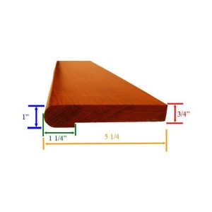

  2. calvin | Jan 28, 2020 06:18am | #2
    You can make up a “stair or landing nosing” or find it at a good lumberyard.
    Carpet would turn and tuck up to it, a lip would go over a kick board on the other side.
    Any stainable hardwood will be fine. Many come prefinished from a stair parts dealer.
    Some yards might have old style white oak thresholds available. Usually thicker and deeper. Would not be a smooth transition from carpet, it would sit higher unless you recessed it down into the subfloor.
  3. freedom13 | Jan 28, 2020 07:44pm | #3
    Thanks tomeseno and Calvin for your swift responses.
    Calvin your diagram has exactly what I was looking for. The thickness of the threshold where it meets the carpet. Also allowing for the bullnose of the threshold is something I had not thought of.
    Thanks again.

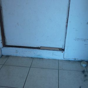

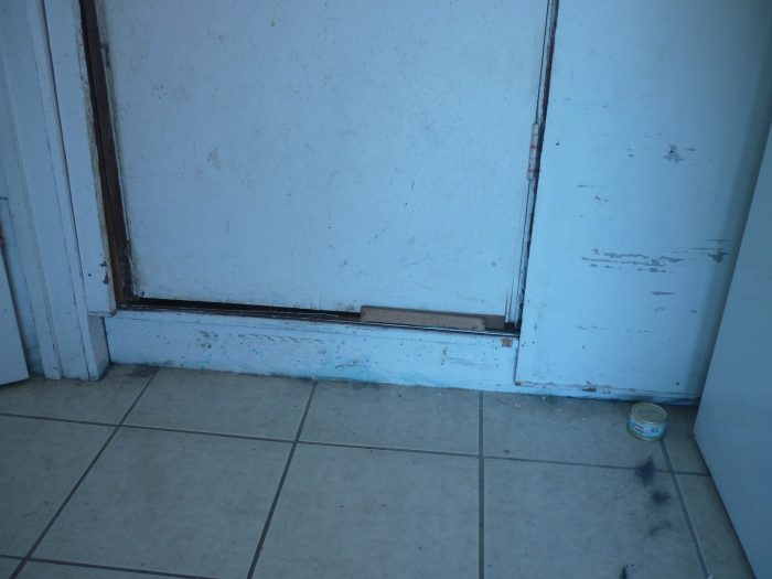

  5. freedom13 | Jan 29, 2020 09:26pm | #5
    Ktkcad, Thanks for your comment. It caused me to go and have another measure up and I think that I will be able to swing both doors inward over the carpet.
    I have attached a picture of the step as it is at the moment with a temporary wall in place to keep the pets from taking over the house.
