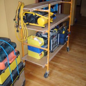

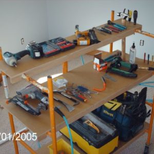

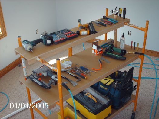

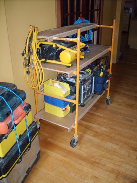

    I work alone, mostly as a finish carp (as metioned above), and I have found a few things.
    Clamps. I like the Jorgenson light duty of all sizes. I have about 50. The spring clamps are good too and C clamps for the heavy torque & to carry things.
    A fold away 4' or 5' scaffold. You can roll it from room to room, put your tools etc on it, stand on it, & work off it.
    Make yourself a set of safe footstools that stack. Maybe 18" high. A JC bucket is not that safe to stand on & work off
    Glue gun to tack things into place while the PL dries.
    Field tools ...portability & lightweight on everything. Folding work surfaces are nice.

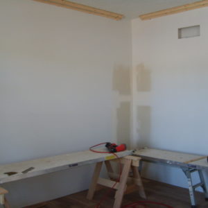

  14. peedee | Oct 25, 2008 11:03pm | #31
    So how do you do long (12'+) crown alone, esp. when they're 6" MDF? I've done a little, and continue to struggle with this. Thanks.
    Edited 10/25/2008 4:13 pm ET by peedee
    1. Jed42 | Oct 26, 2008 04:47pm | #33
      I use blocking.  I cut a piece of crown about 12" and mark the top / bottom on the wall, measure between them, then cut 45 deg. blocks a bit longer than that, and about 4-6 " wide.  1/2" material 1x material, whatever I have around...  I usually only need 1 or two for pine/pop crown, but you can make as many as you want for MDF.  I have tacked these in place as well as screwed them.  I prefer to tack them, as i can cross the nails in the ceiling if I don't have a truss / rafter to nail to.  Depends on how big a hole you want to fix.  It is important to note that it does not pay to try and cut the blocking just right (too tight), and this does require repairing a few nail holes.  But, don't worry - the painter won't mind!
      I also saw an article in FH a while ago (tips and tricks) that had some thing with caulk guns and something or other.  At the time, I decided I wouldn't try it, but you may be able to find it here (??) somewhere.
      Hope this helps.  It works really well for me.
      basswood | Oct 26, 2008 05:01pm | #34
      When running crown solo, I put the coped ends up first, then tuck the end of the next piece of crown in behind the cope. When the first piece is installed, I put a short piece of crown behind the cope to help get the alignment right in the corner, then pull the scrap out to tuck the next piece of crown in.I also use benches and planks around the perimeter of the room, so I can work without climbing up and down ladders.Plenty of backing and good marking of where the crown edges should meet the wall and ceiling help make the installation go smoothly too.

    basswood | Oct 26, 2008 05:13pm | #35
    Good thread.
    Generous use of the Wheel & Clamp!
    Without a helper to schlep stuff around, the first thing I unload at the jobsite is usually a mini-scaffold based cart. I load my gear for the day into the cart and wheel it in. Then I set the cart up for the workday, and it follows me around like a well mannered assistant.
    I also consider weight when buying tools...the lighter the better.
    With apologies to those who have seen this a dozen times before, here is my assistant:

          4. DaveRicheson | Nov 03, 2008 02:53pm | #71
            Aren't you the one with the folding scaffold work station.
            Post him a picture of that set up.
            Sweet!
          5. Shep | Nov 04, 2008 01:53am | #74
            Not me. I'm not that organized.
            That's Basswood.
    2. Jer | Nov 03, 2008 02:00am | #56
      I'm about to buy one of those folding scaffold-carts for a large interior job I just landed. I saw the one at HD for $109, and know that it's probably not the best, then checked out others online for twice & three times that. What do you think & would you get something different if you had to buy again?
      1. spike999250 | Nov 03, 2008 03:22am | #59
        I bought a werner about 3 years ago for 99 bucks  and love it . Now i don't use it everyday but it is holding up pretty well.  I am  short and this thing works great for me.  I made a board to with hooks to hang over one side and fastened a drill holster and old tool pouch to it.  I am thinking about buying another one to make one of those  cool tool platforms i just saw on here again today.
        basswood | Nov 03, 2008 03:26am | #60
        Jer,I just use mine as a cart, and it is great for that. Mine is a Buffalo and it gets poor reviews as a scaffold (for weak casters, but since I don't actually climb on mine, no worries.That is a good price.Here is what I have:http://www.amazon.com/Buffalo-Tools-GSM4-4-Foot-Scaffold/dp/B0001YIUZM
        1. Jer | Nov 03, 2008 06:24am | #64
          Yeah....it's basically the same thing. Husky makes it I think.
