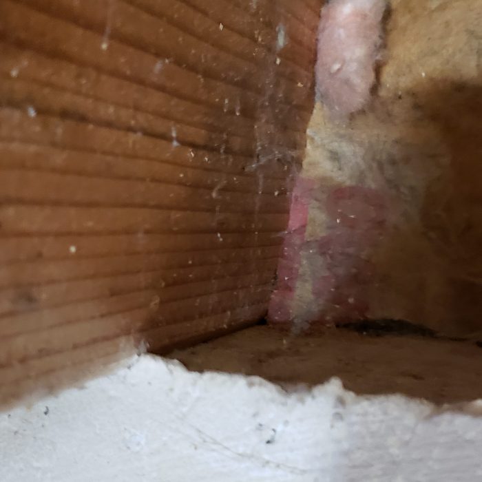

Hi, I’ve got a fun question, I do not have any mudsills, but I also have 2×8 joists that need some sister joists added. I’m in SE Wisconsin and it is a block foundation.
I’m planning on cutting an angle on one side to get it above the steel center support, and cutting a corner off at an angle along the long side to allow me to rotate it into place. Then I’ll glue and nail it to the joist.
Question: do I need to put something under the sister joist to prevent contact with the block wall when it is in place?
