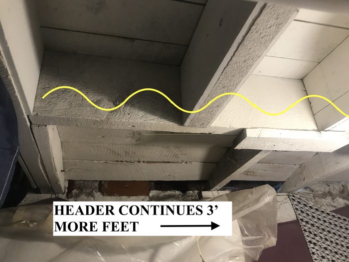

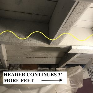

I have a 2×8 header between floor joists that is original to a historic home (dimensional size: true 2″ x 8″).   See pic 1 for a portion of the header highlighted in yellow; too hard to capture the entire 6′ header with a good photo.
I would like to double it up for reinforcement with an additional header right beside it, using a new 2×8  (1.5″ x 7.25″).
Trying to consider the best way to attach the new 2×8;  my thought was to wrap them both in a joist hanger…but not sure how that works when they’re different sizes, both depth and width.

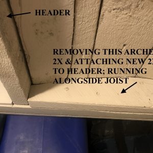

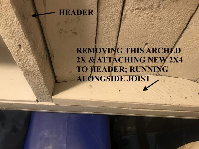

Bonus question:  I’m also trying to run a new 2×4 alongside the bottom edge of this original 2×8 joist  (see pic 2). Any recommendation on how to best hang it off the header, along the joist?  (is there some type of “corner” hanger?)

    With the original 2x8 at 2" plus a new 2x8 at 1.5" that's 3.5 inches. That sure sounds like a 4x hanger to me.

    I'd leave the original in, use a 2x10 that is ripped to 8", so it's actual is 1.5 x 8. Since your original is 2, then you will have a 3.5 wide beam, which can be supported with a 4x6 or 4x8 hanger.
    Bonus question: I'd use a simpson corner bracket to get it in place, and then run 2 engineered ledger screws on a diagonal through the joist back into the beam.
