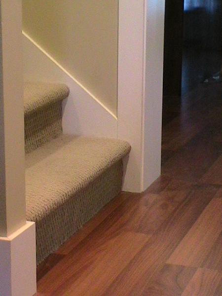

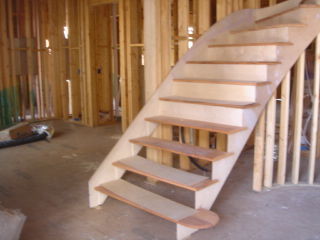

is this the final deal? – looks like kinda out in the passageway to me.

    First of all. How come no one picked this out from day one?. How come the framer didn't pick it out? How come the stairs were already built before this wasn't noticed. Who's job is this?

  2. TomMGTC | Sep 24, 2006 10:54pm | #2
    they do look pretty far out in the passage area. What does the plan show?

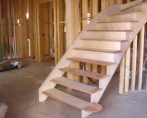

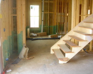

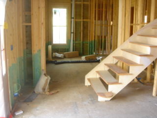

    Did the stair-fab guys deliver the wrong 'case to this job? There's no way that's right...no-one who had ever designed as much as a dog-house would spec that. What a mess. Glad it's not mine, fella. Sorry 'bout your luck.
    Having taken a few more looks at those pics I'm betting this is the result of a misread of the plan for the stairwell framing. Looks like the landing may have been framed too far forward, by probably 2 feet (assuming the rise is about 7 1/2" and using that as a rough reference). I don't mean to be a smart a**, but still have to say I'm glad it isn't my problem.

        My point, while covered in hyperbole, was that no designer, no matter how inexperienced, would ever spec a stair to extend that far into an entry.

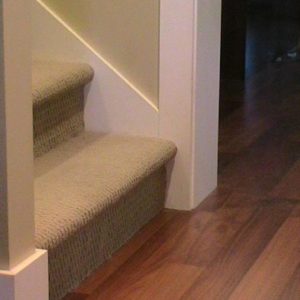

          3. Stilletto | Sep 26, 2006 12:36pm | #20
            I agree with Blue on this one,  I have built more than one set like that.  The part of the stairs that sticks into the arch gets spindles and handrail.
            Not ideal but thats the way these new homes are being drawn up.  10 lbs of sh!t in a 5 lb bag.  And so castles made of sand melt into the sea eventually

    Ed, those stairs might not be wrong.  As long as they leave a clear 36" between the face of the stairs and the  casing of the arch, they are okay. The projection into the wider arch could be an intentional design feature. I've seen more than a few stairs built like that in my day and in the finish, they look okay. The alternative would be to close down the arch to a 36" arch and some people just want a more open look into that room.
    Or, it could be a major mixup.

    with that closed stringer on it I would assume there is a pocket door going in behind the stairs....
    1. TomMGTC | Sep 26, 2006 10:47pm | #22
      That's the part that really makes it look like something is wrong. If it was supposed match the other side with a railing and balusters it should have open stringers at the bottom. Sure looks like a screw up to me. Think we will ever get the whole story behind it?Tom
        I'm guessing that is where the stair guys stopped and said "That don't look right."
        My first thought was a pocket door behind, too.
        But, until OP chimes in, all we know is what is in the photo, and we don;t know if that's finished, half-finished, or half-begun . . . Occupational hazard of my occupation not being around (sorry Bubba)
