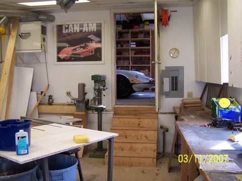

Been wanting to make a tiny, dust-free area in my shop/garage area for a computer station, with just room for me, a laptop, two mid-size monitors, and ventilation.

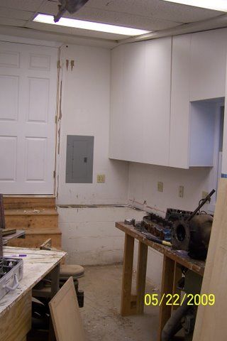

Here’s where I decided to put it – corner by the sub-panel was just a clutter catcher anyway.
The trick is to look at something and imagine it in a completely new way – I stared at it this AM then got to Depo for some 2x4s and a 2-0 door.
To the left in the picture below –

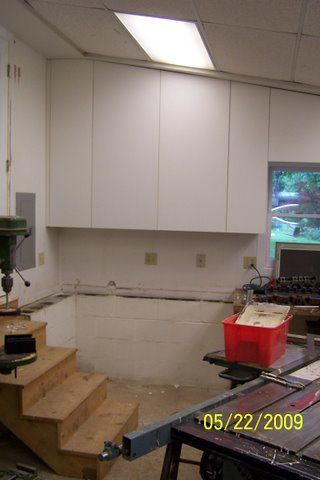

Stripping out the table and stuff –

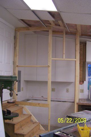

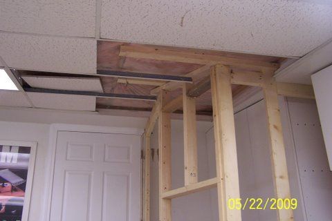

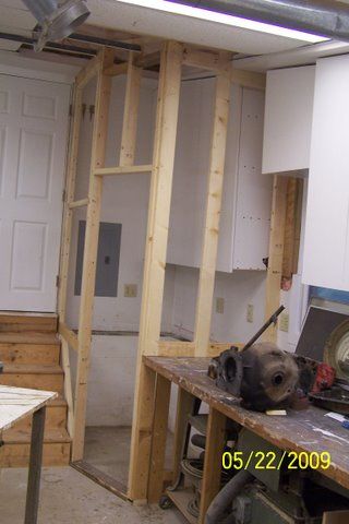

Starting framing – room will be 70 X 43″. That’s INCHES! Seems like it will work, though. Above the stairs will be two 3×3′ window sashes to help the claustrophobia.

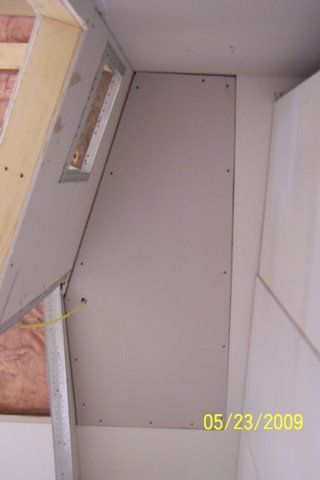

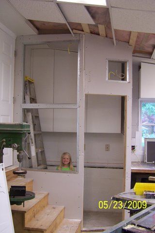

Hung and corner-beaded; put in a solid ceiling so I can pressurize the room a tiny bit -

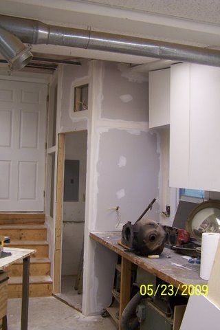

Mudding crew showed up -
All done in time for dinner -

I hope you have flat panel monitors, pretty tight in there. :) Any concerns about having glass windows that close to the staircase? Access to the panelboard looks kind of tight, too. Just sayin'...
No flat panels yet. Two 19" CRTs will sit in front of the panel, yep. Door at top of stairs will have a positive stop.
Tryin to work within the envelope - it's just my non-permitted building in the back yard.
FWIW, NEC requires a minimum of 3' of unobstructed access to the panel. Hate to be the one to say it, but what you are building does not appear to meet code.
It's absolutely true - I do know the rules.
Should I ever care about that, I'll just move the monitors; the roomlet itself is okay. Also, the panel is really visible through the window to the side - it's not like it's hidden. The main 90A shutoff is in the garage up the stairs, within 6' of wher the power comes into the building.
tempered glass - for safety

Looks like a first grader to me!!!!
You ain't had much mudding work recently, have you?
That's about the age of half the Mexican crew I last hired to do such. Course, they had black hair. And would work on Sunday...
Thats just creepy,
McDesign, watch your daughter, bobbys lurking No one should regard themselve as "God's gift to man." But rather a mere man whos gifts are from God.
I dont know why you would say that, He has a cute daughter and she seems around the age of the first graders i read to. I dont joke like that
It was all the exclamation marks you put in your reply that made me do it, crossed my fingers when I responded with that one.
No hard feelings I hope

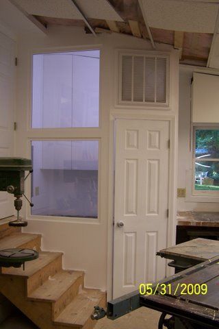

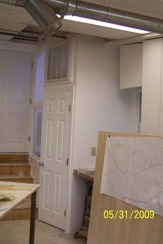

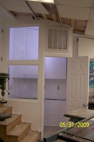

All painted and trimmed out. Now I need to build my desk (actually cut down what I've got out in the camper), build the intake fan, cut in the T-bar ceiling, and get some carpet squares -

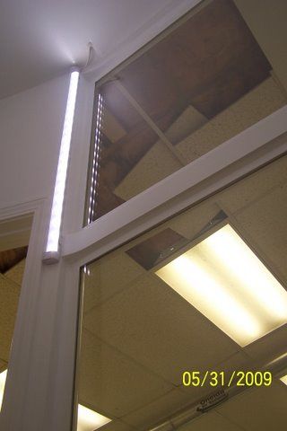

Cool strip light -

Were you planning for more traffic to the office from the stair than from the workarea
or was it you just didn't want the open door into the stairwalk area?
inquiring minds kind of thingAnd now he could feel it- that inevitable craving for cookies! It happened every time he left his firewall down. -Heck '02Elvis had all that he could take from Raven fans, both of them! -Crash '02
Inswing obviously wouldn't really work for lack of space. If he's got the door open a lot, can't block the steps. That leaves.........what we see in the pic. Only practical solution. Yes, cute office!
Edited 6/1/2009 12:54 am by kenhill3
Yes - I can leave the door open and it folds flat against the work table edge.
Note - DW calls it my "Superman phone booth"

What is the light strip beside the door?
Cool idea.
Nicely done.I put a 'darkroom' kit on an office door at my old shop. Kept the dust out.Chuck Slive, work, build, ...better with wood
It's a prototype light strip from Philips - I get a lot of cool things at work.
How much would that light strip run for those of us in the "civilian" world? Is it LED?

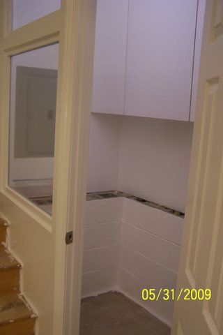

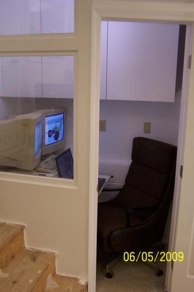

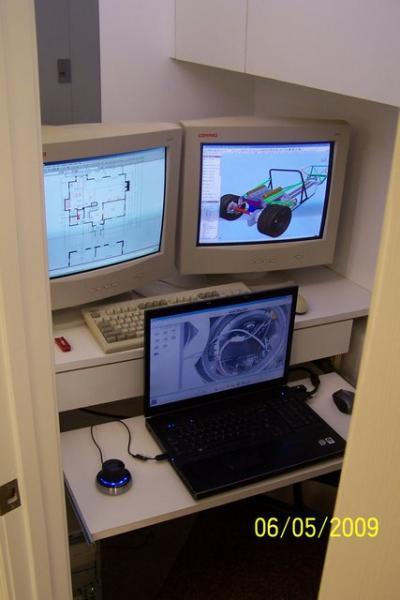

Hey man - Almost finished in here -

I've never worked CAD, what does the wheel for your left hand do?
Good looking project BTW.
Ah - it's freakin' COOL! It's a 3-D (up and down as well) joystick controller for what is on the screen. It's independant of the mouse and keyboard and commands, so as I'm in some command, say relating or drawing or measuring from one side of an assembly to another area, hidden on the other side, I can rotate the object onscreen around to see it better, just as if I was holding it in my hand.
The puck itself doesn't move more than a sixteenth of an inch in any direction - http://www.3dconnexion.com/3dmouse/what_is_3dmouse.php
Like any good videogame, pretty soon you don't really conciously think of moving your hand. I'd say it makes 3d drawing on a 2d screen say, four billion times easier and more fun
Turns Google Earth into Flight Simulator - just fly around!
The one in the pic is $50. I have another version at work that does more - here's their demo of the flagship product - http://www.3dconnexion.com/spp/index.php
