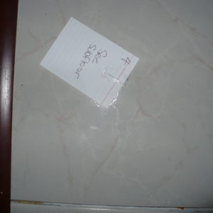

The new photo I posted is of a tile he replaced because he broke it, but I don't think he was going to grout it. I called and complained about this and several other problems, that's when he came over to and fixed it. What he did was put the transition on days before he grouted the tile, so the part under the transition is not grouted. I don't know if this shows through on the photo, and I don't know if this will be a problem in the future.
