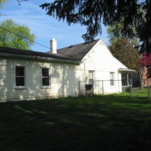

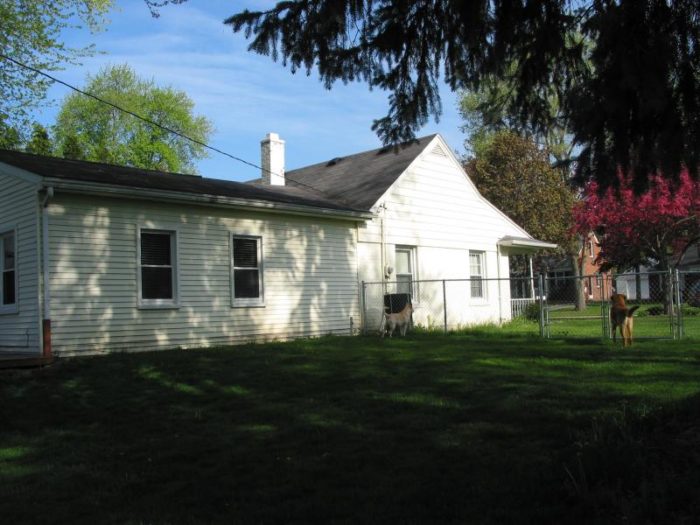

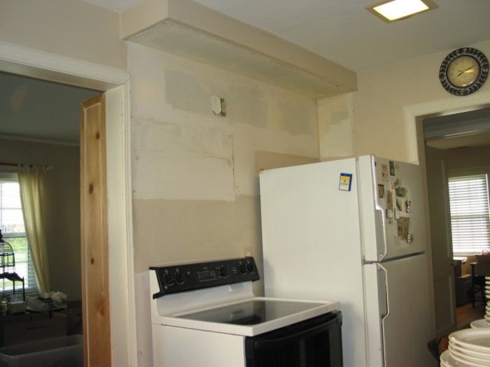

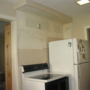

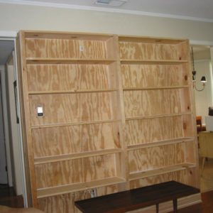

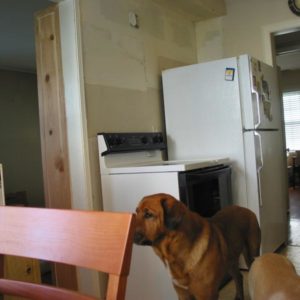

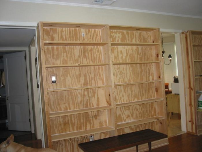

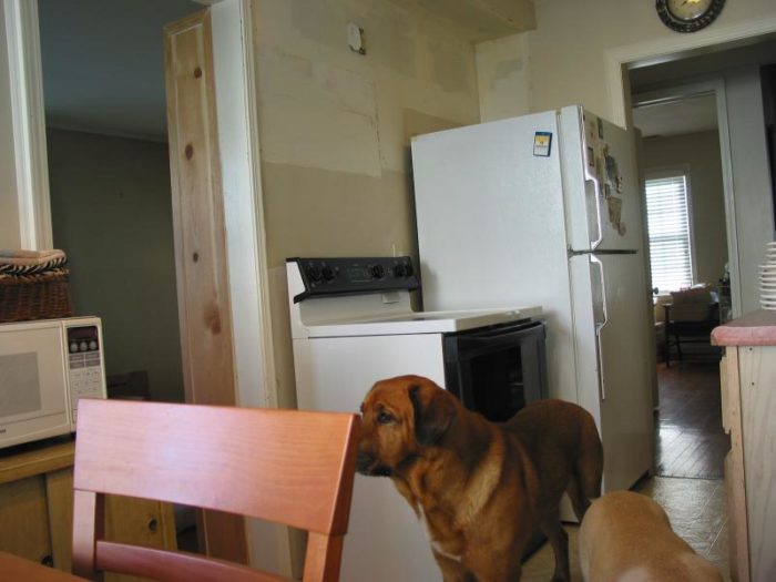

            Hey there, here are a few pictures of "the wall", and some outside shots. This house was a foreclosure sale, although the inspection didn't reveal any surprises and the interior was in good shape, i.e., no holes in walls, no missing fixtures, beautiful white wooden shades on every window. In this area, all of the houses were built in the early forties, and they were all originally approx. 700sq. ft.  One small galley kitchen, one small "front room", 2 bedrm, 1 bath, on a slab.  Of course, nearly everyone has added on, either up, sideways, or back. So my house looks small from the front, but the addition in the back is a big "family room", master bedrm and 2nd full bath. Plus, the lot is 185' deep. BIG backyard with a BIG tree growing up through the back deck :-)
            Ok, I've bored you with that...take a look at "that #$^% load-bearing wall...and note the cute doggies...
            LD
            p.s. that newly built bookcase is a casualty
            ps.s. next time, I'll upload the proposed new kitchen/dining design (done by a PROfessional, no less: ).

          11. ZEEYA | May 06, 2009 04:01am | #32
            DIY Laura
            Here are your pics resized. Aso how about dimensions from the plans the design/builder gave you
            Zeeya

          13. wrudiger | May 06, 2009 06:05am | #33
            Ah, now we are getting somewhere!  "... on slab..."  Certainly not an expert here, but I do know that if you replace the wall with a beam and posts you will need to deal with the point loads from the posts.  The slab will not be up to the task by itself.  Most likely will include sawing a hole in the slab, digging & pouring a properly sized pads for the posts.  One word: engineer!
            Now, that brings up the other aspect of slabs - plumbing (gas & water are typically under the slab and drain definately is).  So unless you want everything to stay where it is now plan on having the concrete saw team prep for the new plumbing at the same time.
            I've built a few houses (years ago now!) and just built & installed all the cabinets in our new kitchen.  I'd hire out structual and plumbing on your project!
            Beyond that it's all a mater of comfort with tools, patience, willingness to tear out & re-do (mistakes are a given - one difference between dyi & pro is how quickly and cleanly the mistake is fixed).  It will go slower than you can possibly imagine and will be remarkably frustrating at times.  And in the end will be an incredibly rewarding experience (give it a few months after you're done!).
            Which brings up a critical question - where is your temporary kitchen going to be?
