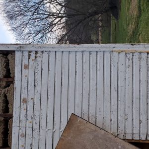

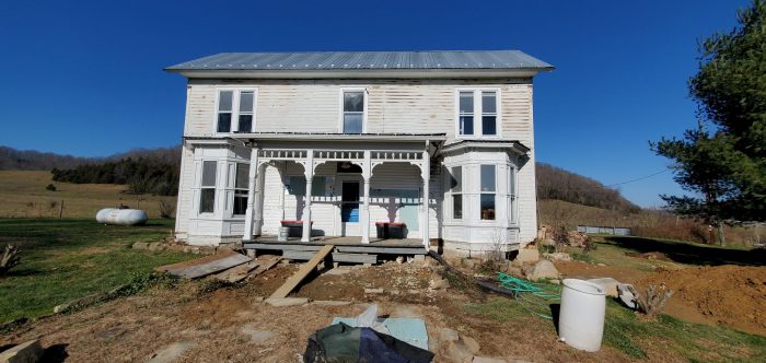

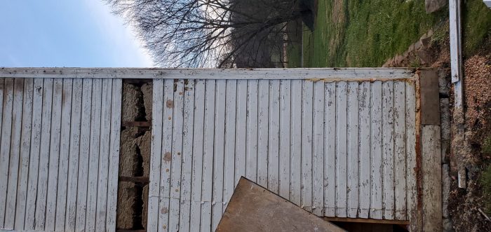

1899 farmhouse in very rural Zone 5 with original beadboard walls and ceilings on first and second floors.  Fiberglass batts in the attic. Blown-in insulation to exterior walls in poor condition and will be removed.  No sheathing. True 2×4 studs.
For exterior walls: Removing original wood siding (much of it can be reused). How best to insulate up against the back of the beadboard wall? Prefer to use mineral wool batts and not spray foam. Can it go up against the back of the beadboard wall? Then add plywood or similar sheathing, house wrap, and then reattach wood siding? Should I apply some sort of air gap? Recommendations for how best to achieve this?

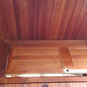

For attic: Should I remove the fiberglass batts and create an air block between the joists and beadboard ceiling. I read a recommendation to lay cardboard between joists and then spray an inch of foam to create air seal but also protect the back of the beadboard ceiling. Batts could be relayed after the foam. Agree? Other ideas?

    I would want a vapor barrier in the walls. you could cut and fit some foil backed drywall at the inside of the cavities, and seal edges with a pro foam gun. this would leave room for the 3.5 inches of rock wool you plan to use.

    Walls: beadboard, paint back side to seal it, 3.5" rockwool, 1.5" zip/insul board, vert strips, old siding, paint. (or new siding !)
    Attic: remove all FG batts, vacuum, air seal, 3-5 mil plastic vB, 20" of cellulose, vented eaves and ridge.
