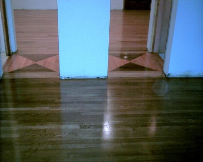

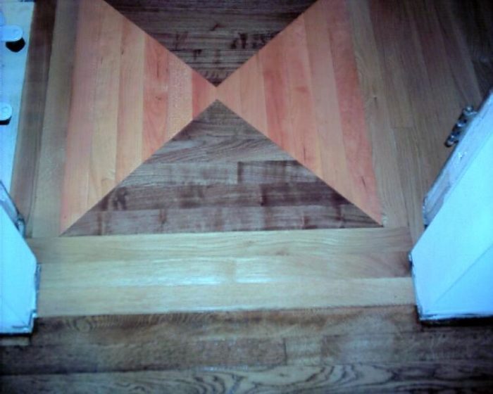

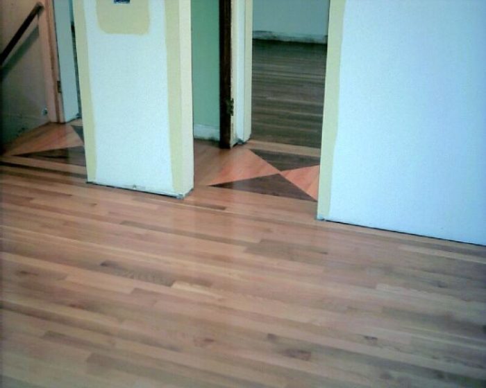

We stained the old floors and finished the new floors natural. 1/4 and rift w.o. Details are 1/4 sawn walnut and cherry.
Ditch
Ditch

That's an eye opener for sure. Nice work.
Ken Fisher
Thanks Ken.
I've been meaning to put a cd together...and get a copy to ya.Ditch
very nice detail.
do you spline or biscuit or anything, the mitered joints?
I try to lock as much as the floor as I can. The mitres are splined.Ditch
