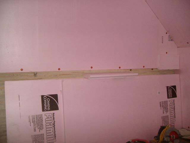

My lastest room remodeling I am installing 2" XPS and furring strips to the inside walls and then sheetrocking. I remove the plaster but not the lathe.
I was a professional insulator with good equipment, and I still found walls that were not blow to the level that I expected in the last room remodel. I drilled test holes.
Other areas of the house I have been very pleased with the density of the cellulose job.
Attached is a picture of the work in progress. I put the 2" XPS on the ceiling, slants and side walls.
