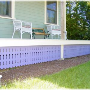

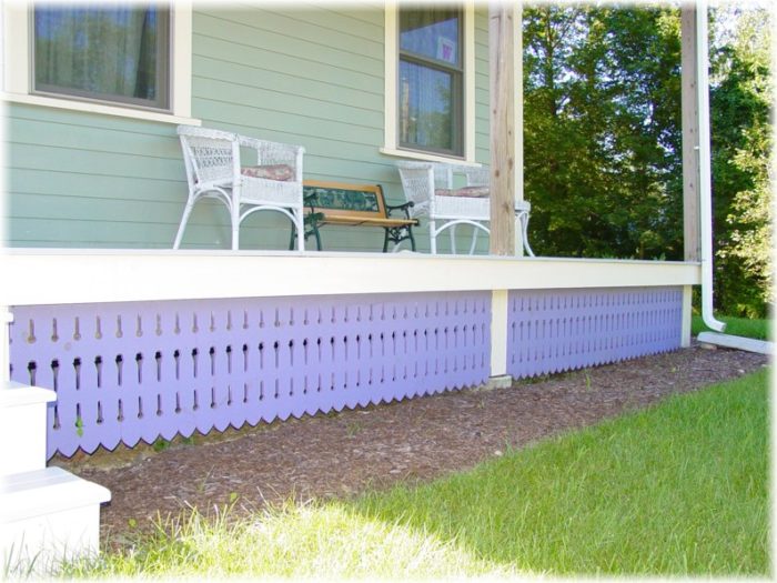

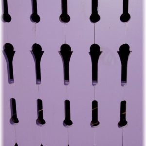

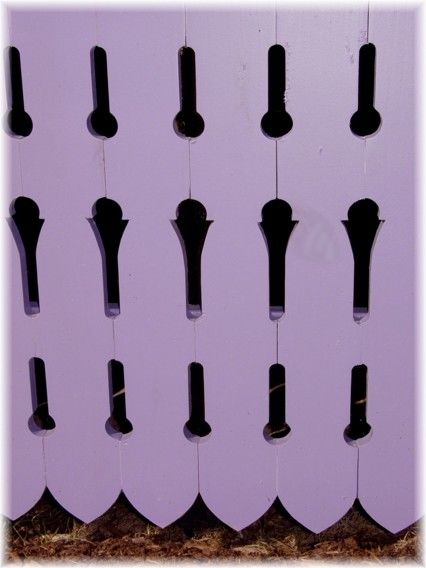

           I agree with you. The lower railing heights on older porches looks a lot better than todays 36" standard. Besides, what scientific wiz figured out that 36 inch railings are much safer than 34 or 32" railings? (Although many older houses have railings much lower) The code certainly doesn't take aesthetics or proportions into account, but that's what happens when the Insurance industry basically runs the country.
           I did my porch over on my house this spring and I cut out the gingerbread for the skirt myself using a template I made and a pattern bit on my router table. (Because I also can't stand the cheap home depot lattice) I posted a few pics for ya.
           As for old construction techniques on porches...here in New England you can't beat the look of the old tin roofs on the covered porches and houses. Also you see all these old porch columns that were made from Yellow Poplar, or Fir, still standing strong...many well over a hundred years old, and then you see the guy next door that used pressure treated 4x4's est. and his porch is falling apart! Also the level of detail can be amazing on some of the older houses. I love how the old time carpenters mitered the cornices on the rakeboards and carried them down along the soffits, all the way around the house.
          PS (I haven't gotten around to picking out porch posts yet! So excuse the 4x's in the pics!)
