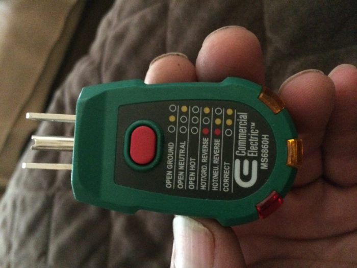

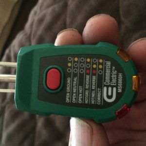

    Metallic boxes with conduit has grounding provided by the conduit so easy fix is swap out self-grounding 3-prong outlets for the 2-prong you have now. Metallic boxes wired with BX cabling might be grounded by the cable's sheathing if properly installed and maintained. Easy fix is same as above but pick up a cheap circuit-tester (see pic; should be ~ $7) when you buy a 3-prong self-grounded outlet to install so you can check for proper grounding once it's installed.

      The cheap circuit testers for grounding are not particularly reliable, but probably better than nothing.
