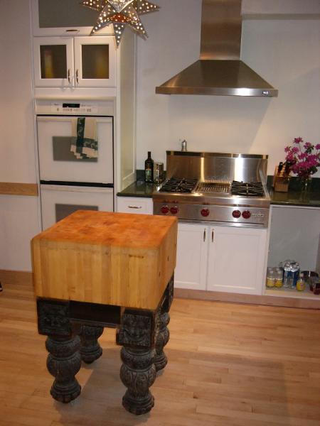

Fellow breaktimer David Espostio have been working on a new kitchen for my c. 1913 Baltimore house. We finished the carpentry yesterday. There’s still some painting and touch-up to do. But I thought the kitchen was far enough along to post a few pictures. Many, many thanks to all the Breaktimers who provided such valuable advice along the way.
FYI, the floors are reclaimed maple. As David will attest, the boards arrived in much worse shape than we were led to believe. So we spent a good thirty hours between us, scraping the tongues of every piece and then sorting usable boards from unusable.
I built the base of the central butcher block from some salvaged dining room table legs. I’m not sure of the vintage of the table legs, but the carved faces are definitely not for the faint of heart.
The kitchen design evolved from the desire to grill inside. That determined the purchase of the Wolf rangetop, which in turn dictated the vent hood, which in turn set the location of the appliance, since there was only one ventable wall.
I’m proudest of the schedule we kept to. I promised my wife that our kitchen would be disconnected for a maximum of three weeks and four days (a timeframe that included a week for drywall and and taping, and a week for the installation and finishing of the floors). Thanks to the brute hard work of David Esposito, and the flexibility of our subs, we met our schedule to the day.
I’ll post four pictures. Hope you like them.

What make hood did you use?
I used a Broan "Best" hood (model K42) which moves air at about 1200 CFM. I thought it was overkill, but now, having grilled several times, including sausages, which flared up nicely and generated a ton of smoke, I'm a believer. The hood sucked it all right out. Expensive, though. Like $1700. And a bit of a pain to modify to tie into horizontal ducting.
Ah cooking! Well I do those sausage cooking outside with the camp burners. I like the butcher block, the feets are just right! I notice the "light" above it, what is it?
Bluegillman
The light is a hammered tin piece from Mexico. We found it in a shop in Georgetown (D.C.) which specialized in Mexican imports. I wired it up with some lamp parts from the Despot. It doesn't give off much light, but it's atmospheric and the the recessed halogen task lighting we installed takes care of the practical needs.

I was reading your thread, as I came to the part of the carved legs I couldn't wait any longer, had to click on it right away!
Man those are some legs!!!
Nice looking kitchen, and I do like what you did with the butcher block.

at 38667kbs it took mine nearly two minutes to download this one. The photo size is actualy not bad as he uploaded it but some kind of excess info must be included in the file. Here is my resave after only minor edit, much smalller file but still took 57 seconds to uploAD

nice kitchen however one thing i noticed was the raised panel on the right side of the stove does not go down to the cabinet which i feel it should have . was that an after thought ? that want on after the templating ??
The raised panel wasn't an afterthought. I guess where it ends is simply a matter of taste. I decided to scribe it to the countertop, rather than have the countertop scribed to it. I think that results in a cleaner joint at their intersection, since the panel covers the slight gap that the countertop guys left so they could fit that small piece.
