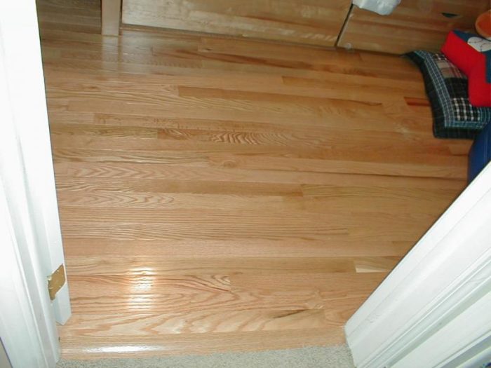

I wanted to thank all of you that contributed to my knowledge base re: pre-finished hardwood floors. A few months ago I installed a pre-finished oak floor in our son’s 8×10 bedroom (yes…just 8’x10′ – just one of the many reasons we’re building a new & bigger home soon). I decided against the normal wood floor because of the timeframe to get him back into his room and because he’s already very sensitive to various asthma-inducing “stuff” so I didn’t want him breathing anything ‘bad’. Plus we wanted to take out the carpet in his room and let him try hardwood for a year to see if it would help his breathing since he struggles a bit w/asthma. Unfortunately we just did some allergy testing on him and he’s allergic to just about d*mn near everything!!! But I guess the floor will be some help according to his doctor.
Anyway, here’s how it turned out. Keep in mind I work 60-70 hours a week as a salesman…wood floors are not my specialty! 🙂 In fact aside from a Pergo floor I installed about three years ago this is my…SECOND floor ever!!! Thanks again for the help everyone.
– Rob
Sorry all, it was my first time trying to download/upload pics to the forum. Looks like I jumped the gun…hopefully they appear this time.
Thanks,
Rob

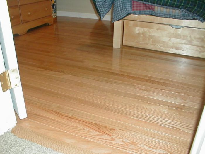

Rob, looks like a very nice installation.
Not a criticism, but more a tip since you wrote you're going to be doing a lot more of this in the future...try to stagger your joints from one run to the next a bit more. It could certianly just be the way my eye deciphers the wood grain in the pics, but in a couple of spots in pic #2 it look like adjacent butt joints are as close as one board width, or 2-3", apart. Again, it could just be my eye being tricked.
Sometimes it's tough if you end up with a lot of shorts.
Again, not trying to be picky...just for future reference.
Still, nice job, congrats!
You guys are being too nice. After I posted that pic I thought to myself "stupid, stupid, stupid!!! Don't let them see that stuff!!!". :-) But you're right, I did get moving a bit too fast and wound up with some butt ends aligned too closely. Will remember next time.
That was the one downside to the pre-finished floor is that there seemed to be a lot of short pieces. This wasn't a problem in areas where I knew I could hide it, like in the closet or where I KNEW we'd have furniture but it did become a bit of an issue in the center. But had I planned a bit more carefully I could have overcome it. Thanks guys.
- Rob

Mongo's comment.....well he's right to a degree,,,,IMO you "just" got away with the butt ends being close. Doesn't look bad on that issue but Mongo has a pont you should be aware of for the rest of yer floor.
