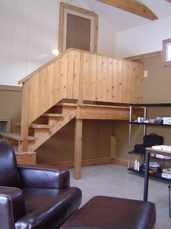

My dilemma is: The stupid stair case he put in. I have a vaulted ceiling and he put the ridge of the addition right under the sofit of the main roof. So I can’t move the door, right now it’s just a storm door on a rough opening that I have changed to make it look nice.
If you could pull the staircase out and put something new in, what would you do? The ceiling height reduces at the hinge side of the door, so I can’t go that way.

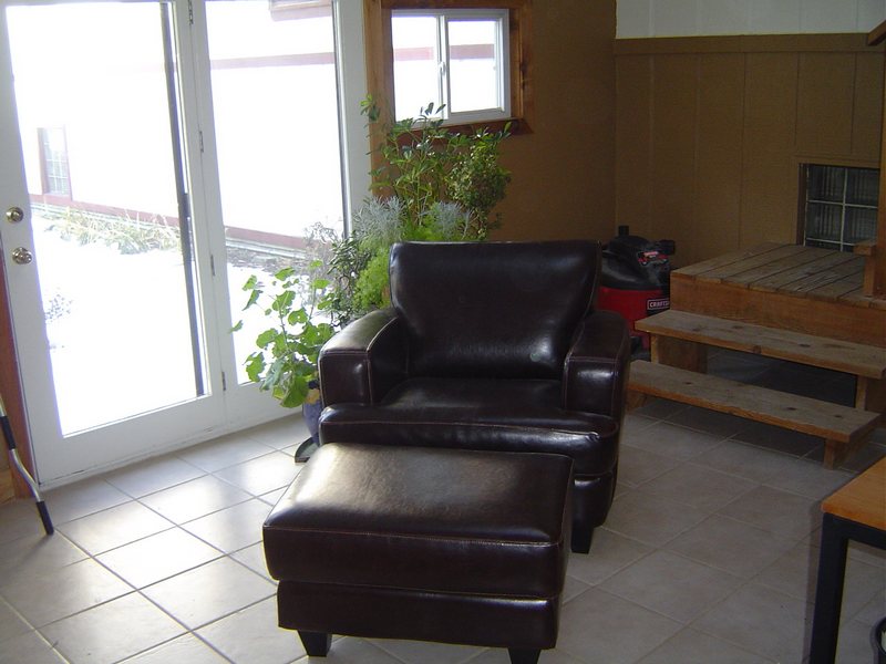

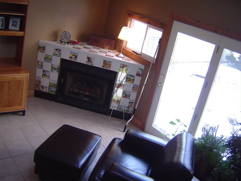

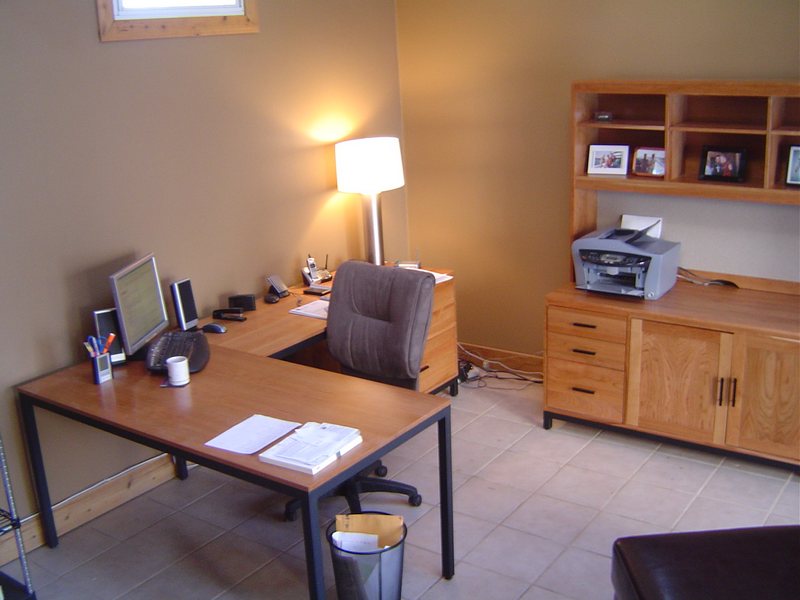

Here’s the office, it’s 14′ x 17′ and a lower elevation than the steam pipes in the basement, so no chance of steam radiator install:
I will remove the fireplace.

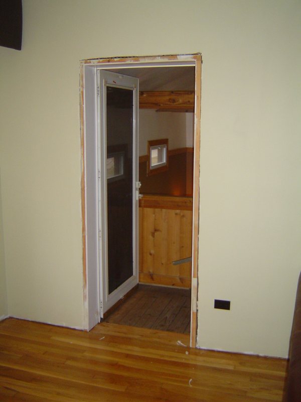

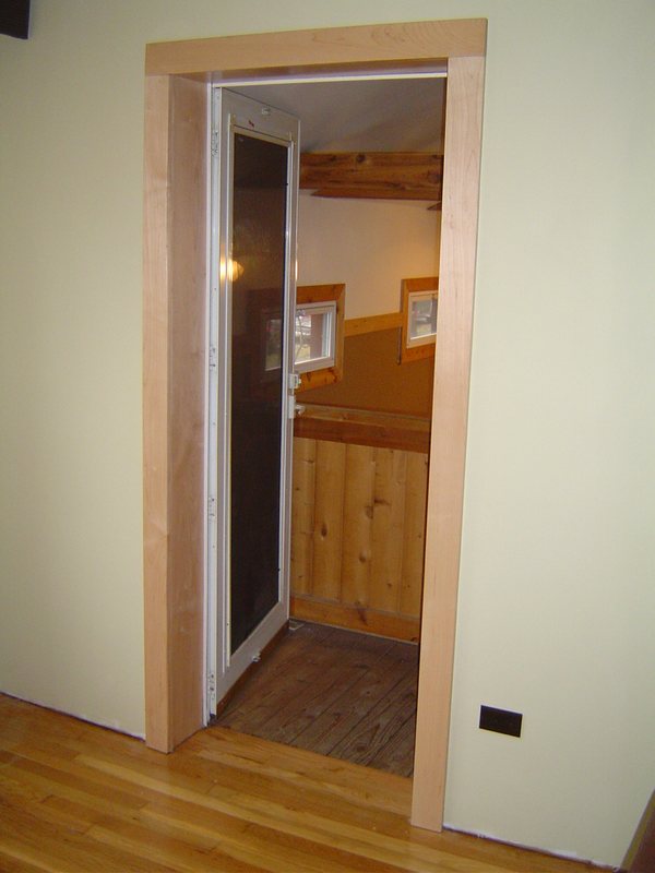

Here’s my living room entrance, it’s just a rough opening, I have since pimped it out a little with some maple trim and a “Q” door panel I made:

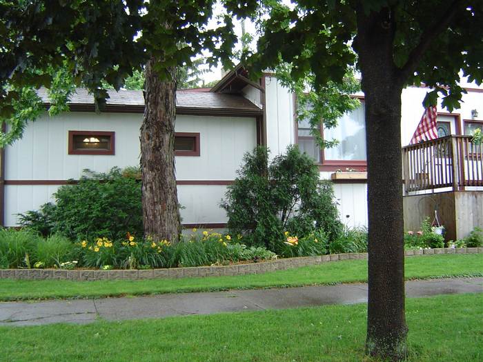

Here is the outside of the addition so you can see how he hacked it….the back side, no it’s not that over grown any longer…

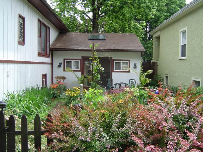

The front side….

    What a lovely tacky fireplace.

      No, I want to get rid of the stupid wood stair case and landing (that doesn't even allow the door to swing all the way because it's 1/2" short on the width).....
      Any ideas? I guess you don't want a step down, you want to walk into a landing, then have a stair case.....but thought somebody here would have a good answer.
      Maybe a storage unit under the landing/stairs.....and I would probably do bamboo floors, so maybe bamboo stairs.....

    Curved stairs are a bit harder to navigate than straight stairs, so I'm not a big fan.  I can see two options for you:
    Keep the same basic arrangement.  Redo so the landing is wider, contemporary or traditional railings--open, not closed up like the one you have.  Where your top tread is, flush with the landing, should be one riser lower, saving you some space at the bottom.  Close in under the stairs with some deep drawers or doors with shelves behind.
    Option two would be to just have the stairs go straight down from the doorway.  You'd want to move your desk to the area where the bottom landing is now.  Enclose the whole underside, or make it more of a "floating" staircase with some fancy framing or metal work.
    Could you change the door swing so it opens back into the main house or would that interfere with traffic flow too much?
    Could you change the door to a barn-type slider (as opposed to a pocket door), mounted on the wall?
