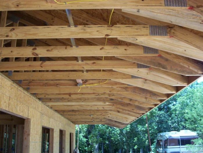

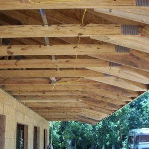

I have attached a picture of the wraparound porch I am building on my house. It is 10′ all the way around. Ceiling height is 9′. Total square footage  of porch is 2400′. Front and back is cantilevered from the trusses. The two sides are attached “trusses” engineered for this purpose. They will have to be supported by a column and beam (?) To get the full 10′ I have taken the stamped concrete porch to the drip edge (will have guttering.)
1) What kind of material would you use for the ceiling?
2) Since I have to have a beam on the two sides, therefore the front as well for aesthetics, would the beam look best being a 2×12 box (tall) or a shorter 2×6 box?
I know everyone likes to hear that cost is not an object, but this porch has cost me a bundle.
Thanks for any advice.

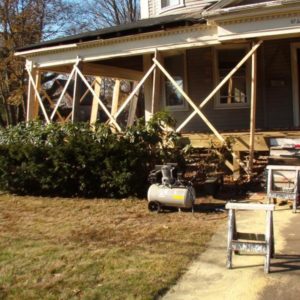

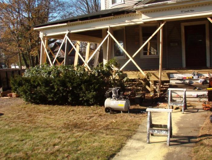

    I'm renovating a 600 sq ft porch that I thought was ginormous, so I can't even image what yours is costing.  Mine is 10ft deep on the front, and there is an original 12" deep box beam all around that I was able to save - it looks great.  The ceiling is t&g fir beadboard.  You might want to study local custom - around here, I'm told that to be truly authentic I would paint the ceiling sky blue (I'm not doing it!).
    I attached an old picture from the early days of the project.

    Check with the company tyhat made your trusses - You may not need a beam out there at all. We routinely cantilever trusses out over porches.
    That might give you some more design options, if you don't need structural posts and beams.
