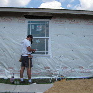

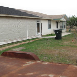

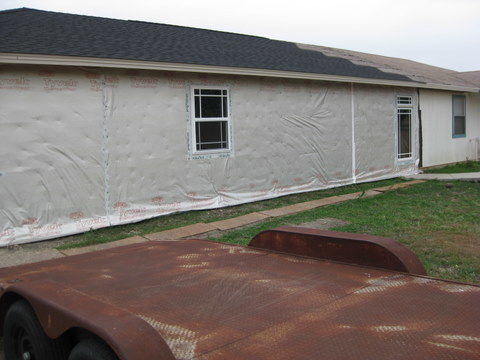

        2. blownonfuel | Jun 17, 2009 04:18am | #10
          Here are a few.
          1. frammer52 | Jun 17, 2009 04:23pm | #11
            There you go!
            A black roof?   Didn't you hear about BO secretary telling us to use white?
          2. blownonfuel | Jun 17, 2009 04:42pm | #12
            Yeah I heard about it. I'll let them come and tell moma that we need to change it to a white roof.
