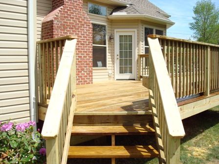

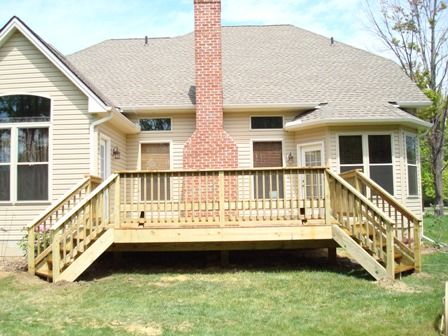

So a helper and I just finished a 16’x19′ deck yesterday. Except for the 4 trips to the lumber store(not my takeoff, HO supplied materials) it couldn’t have gone better. Finally after all these years of accumulating tools it finally seems to be paying off, as far as ease of construction goes. We spent 1.5 hrs on the previous day digging 3 holes, then we left so the inspector could do his job.

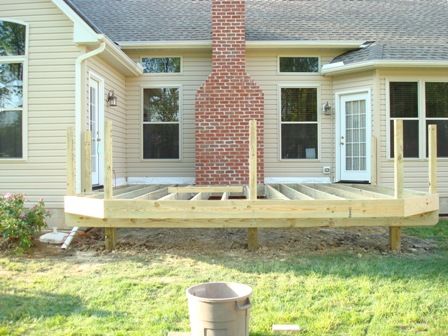

So on what I consider Day 1 we demo’d the vinyl siding, set posts & beam, joists, box and posts. Nice day 65 and sunny.

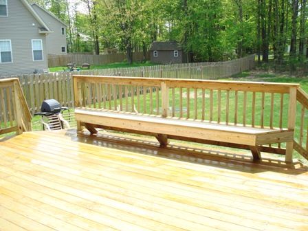

Day 3 starts out with a Rancatures album so I have a lil trouble getting started but he's jammin so I let him go on the bench seat.
I take care of the stair rail tops then move on to reinstalling the vinyl siding. He finishes the bench, cuts the rail tops, we clean up and head home.

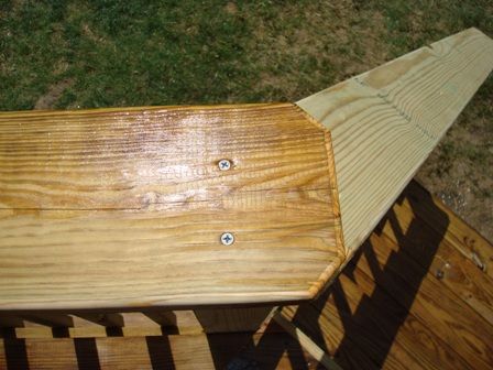

Nice looking deck and looks like you made good time on it too.... hope you made some good cash as well. I like the chamfer on the rail.... nice touch.... it's the details that seperate the best from the rest.View Image
Clipping the corners seem to always look a litttle better. With this one we used a laminate trimmer with a 1/4" round over bit and rounded over all four corners of the top of the rail. Makes it look nice and soft.
The details are at the top of the stair rail butting into the rail post on the main deck. Had to cut a V (52deg. on a 29 bev)on the stair rail so that it would wrap around the post. Took some time but came out great.
