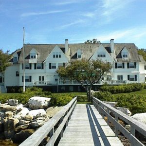

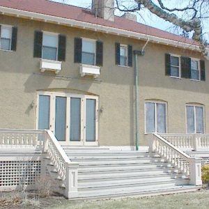

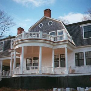

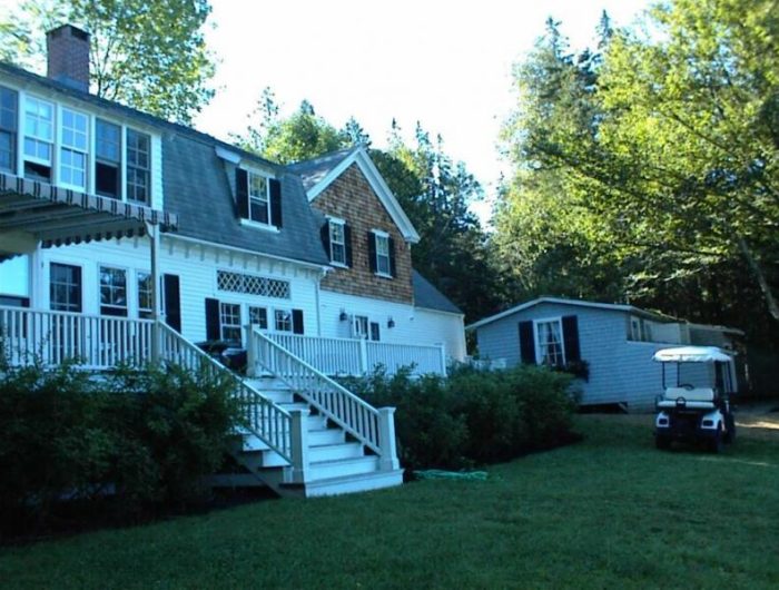

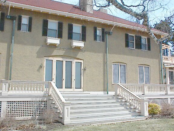

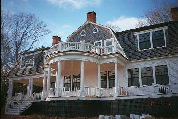

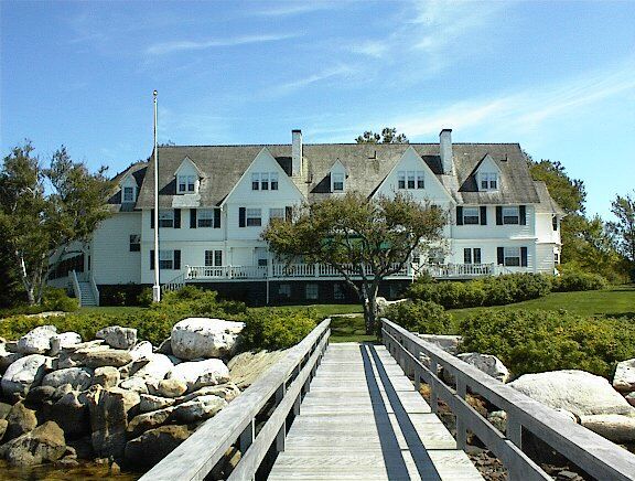

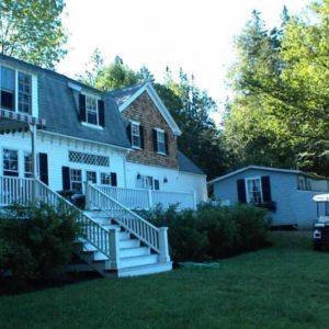

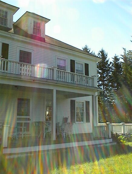

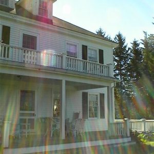

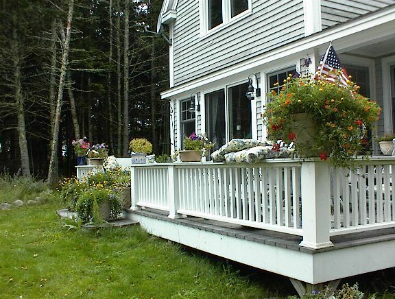

            Yes, let's see if I can find a photo or two...These places were built for view of the ocean and a nice sea breeze.These are from several different homes all built around 1896-1908, grabbed quick without me reviewing all details since I was just looking at thumbnails, but mostly showing original decks - some combined with porch and or balcony areas raised over. I have others where the redesign/rebuild was so extensive that it bears no semblance to the original.I am aware of the history on many of these from taking with the retired carps who worked last on them, and from seeing how many series of nails had penetrated tops of joists in re-decking the frame.Back then the 30# paper over top of joist was common, and often, what I removed even had the old pitch paper instead of tarpaper!
            Gene_Davis | May 28, 2009 10:39pm | #17
            C'mon, Paul.  You are showing places that have full-time caretakers to maintain those decks.
            Let's see some middle class housing from 100 years ago with original decks, not places akin to the Newport "cottages."

            Dam_inspector | May 28, 2009 11:36pm | #18
            Piffin himself has been maintaining those decks for the last 90 years.
          5. Piffin | May 28, 2009 11:53pm | #19
            What I was showing was evidence that houses did indeed have decks attached a hundred years ago. Somebody didn't know that was true.yah know a deck doesn't need much other than shoveling the snow off it and oiling the surface every year or two.
