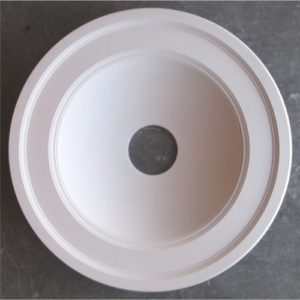

      Jeff_Clarke | Apr 09, 2008 06:36am | #10
      Yes I would agree with Piffin on that.   There is a good company in Utah that makes custom GFRG (glass fiber reinforced gypsum) domes - I had two made for our great room (they are circular, about 22" in outside diameter) and I sent them a piece of our casing to cast into the edge - this made them easy to install (face screw, liquid nails and patch holes).
      Company - http://rwm-inc.com/  - They are really good people.   Oval domes - http://rwm-inc.com/domes/index.htm#od-recessed
      In your case, the issue is how to create a 'void' in the center by modifying the ceiling framing - this isn't usually DIY work.
      eta - rwm must have liked them - I just noticed that they are featuring the custom domes that they made for me on their website for $199 apiece, which is a deal - see photo below

        Jeff_Clarke | Apr 09, 2008 06:44am | #11
        Here is the photo

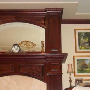

  9. CardiacPaul | Apr 10, 2008 12:52am | #30

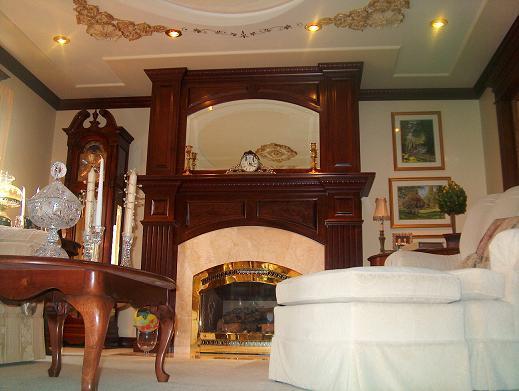

    Here are some pics of a ceiling I did in my home.
     No one should regard themselve as "God's gift to man." But rather a mere man whos gifts are from God.
      Joe | Apr 10, 2008 02:22am | #32
      Paul,Very nicely done.http://www.josephfusco.org
      1. CardiacPaul | Apr 10, 2008 02:27am | #33
        Thank you very much. No one should regard themselve as "God's gift to man." But rather a mere man whos gifts are from God.
    2. james77 | Apr 10, 2008 03:05am | #34
      beautiful...beautiful...beautiful....that is exactally what I've been looking for...would that be refered to a Coffered ceiling? Just how did you frame it and what did you use? You did a great job on the whole project. How long did it take? did you use textured paint? More inportantly how did you do the oval? Please. please give me something it looks magnificent!!!!
      1. CardiacPaul | Apr 10, 2008 03:40am | #37
        Thank You.

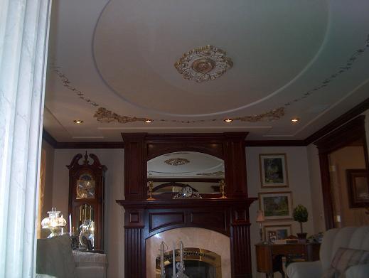

        A lot of designs went into that ceiling, The room is only 8' high so I did'nt want to encroach on scale of the space, so what I did was overlay the ceiling with 5/8" DW leaving the oval out. I did the lay out on the floor, did the two nails & string trick to lay  out the oval cut it out, glued around the perimeter of the oval & screwed of the rest with 2" screws, Then I added a 14" perimeter band of additional DW around the room & glued & screwed that off. The raw edges of the new drywall layers where finished off with plastic DW round overs & mudded in.  The plastic DW caps only come in straight lengths so for the oval I had to heat them up & bend them while keeping them flat. I also made my own DW knife out of galvanized sheet stock to float it all in.
        As for how long it took? I started the room in 1998 & had the carpet put in Dec. of 07 I was on the Frenchy schedule!! LOL.
        When I got all done I asked my wife if had been worth it all? She responded with
        "Five years ago would have been worth it, Now is about time!!"
        The ceiling it self only took about 20 hrs.
        Most of the millwork in the room I made myself & is all cherry, it all started when I bought the cherry Grandfather clock, the room was all oak & didn't have the fireplace No one should regard themselve as "God's gift to man." But rather a mere man whos gifts are from God.
        1. james77 | Apr 13, 2008 04:17am | #46
          very nice job, with the help I have gotten from you guys I think I am ready to start laying out some lines....thanks fellows....Jim
          1. CardiacPaul | Apr 14, 2008 04:58pm | #47
            Best of luck to you, if you need any more pics or detailed infomation let me know.
            Paul No one should regard themselve as "God's gift to man." But rather a mere man whos gifts are from God.
          2. james77 | Apr 15, 2008 02:22am | #48

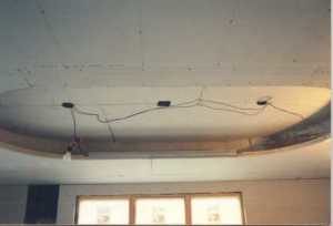

            Paul, do you have pic's during construction? I am still not sure how you attached the lumber to the ceiling rafters. Did you remove the old ceiling?
          3. CardiacPaul | Apr 15, 2008 03:26am | #49
            The center of the ceiling or oval is the original DW,  surrounding the oval is just 5/8"  DW laminated over the existing ceiling, no framing involved for my ceiling. So my ceiling is just layers of DW, no framing added at all. I do have so pix of the job underway, but I'm sure where they are, sorry
            Paul
            Edited 4/14/2008 8:30 pm ET by CardiacPaul

          5. CardiacPaul | Apr 15, 2008 05:37am | #51
            Thanks Jeff,
            I'll be posting more pix of the house soon, lots of details to share.

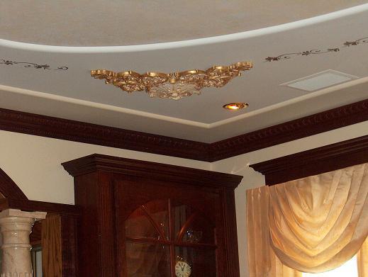

            Your right about the depth, with the plastic bull nose the steps are about 3/4", really adds a lot of drama & richness to the room.

          8. CardiacPaul | Apr 15, 2008 05:59pm | #54
            Jeff,
            The bullnose I used is designed for the  5/8", it radius from the higher ceiling to the lower ceiling & has a flange & mudding ridge.  The outer edge of the bull nose is 3/4" thick & the flange is 5/8", by the time you mud it in the  1/8" difference disappears
            I got the bullnose at my local DW supplier & is made by trim-tex.
            As for your use in your living room, it is a great solution, I removed a closet in my master bath & replaced it with a floor to ceiling corner cabinet, instead of trying to repair the ceiling without any scars or ridges, I used the border treatment around the room covering where the closet walls intersected the ceiling, basically I covered up the old scar instead of repairing it.
            Hope this makes sense No one should regard themselve as "God's gift to man." But rather a mere man whos gifts are from God.
          9. james77 | Apr 15, 2008 10:16pm | #55
            the edge of each layer, what type of molding did you use? nice paint job... is the scroll work plaster or plastic?
          10. CardiacPaul | Apr 16, 2008 02:29am | #56
            The bull nose edging is plastic by trim-tec & the medallions are plaster that I had made up for me at a plaster shop in Milwaukee No one should regard themselve as "God's gift to man." But rather a mere man whos gifts are from God.
