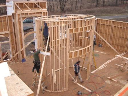

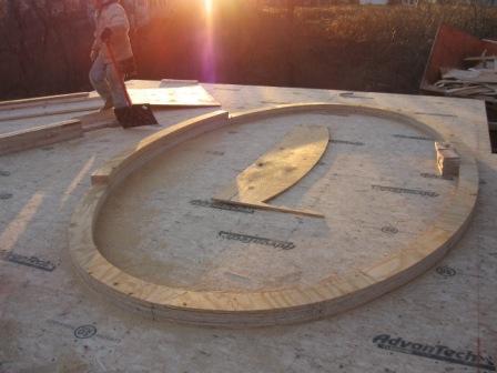

Here are some pictures of a house I’m framing right now.
The house has some interesting things about it which photograph pretty well.
The oval room/hall is located in the center of the house and connects the foyer, great room, master suite, and library/music room.

Good looking shots there, are the openings in your oval walls going to have doors in them?

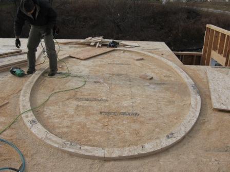

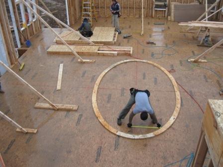

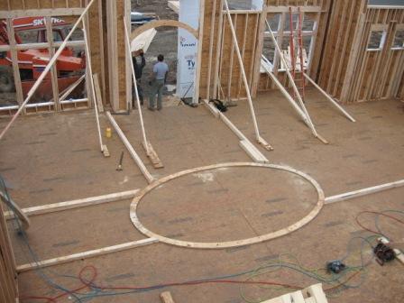

In the first few pics it looks like you are cutting out round plates, and your room is an oval. Are the round plates part of the oval? I may be looking at them wrong too.

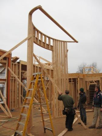

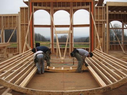

The openings will have arched tops, and will be cased(no doors).
The lower seven foot wide openings will have level tops with the openings/windows above them arched.
We made our headers 3/8's narrow on both sides (of the width) to receive plywood later which we will cut our arches in.
We experimented with making our headers first with bending azek with relief cuts in it, which was okay but then we resorted to bending layers of 3/8's cdx and 7/16's osb.
The plates look round in some of the early photos, but they are part of the oval, a perspective thing.

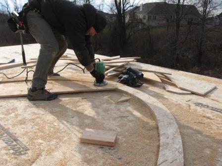

nice blog site with all the pics. one question though , do you free hand all your radi ?
For the oval room the architect gave us the overall dimensions.I looked up the formula for tracing an elipse, laid it out for the first set of wall plates, cut them, then went to town with the router and a panel cutting bit for the rest.
