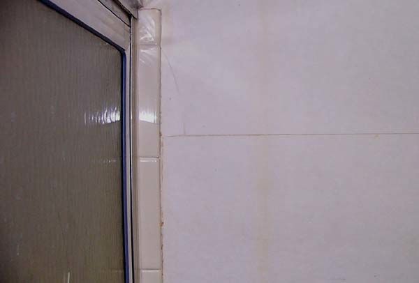

This bathroom has been previously wallpapered.  That wallpaper was peeled off  and of course took some of the drywall facing paper with it (wasn’t sized).   So,  wallpaper “liner” was put up to smooth out the peeled areas.  Then more wallpaper.  Again,  wallpaper peeled (imagine that hapenning in a bathroom!).
So now they want to paint instead.  Here are the questions.
Can wallpaper liner be painted?  Should it be primed or “sized” first?
What about any gaps in the liner (see attached picture),  will spackling work?
TIA
Phil
  1. FastEddie1 | Mar 27, 2004 07:05am | #1
    If the paper has peeled, what makes you think the paint will stick?  IMHO you should strip the liner, skim coat the walls with all-purp mud, then paint per spec.

  2. HeavyDuty | Mar 27, 2004 07:53am | #2
    Well, nobody says you can't paint wallpaper liner, depending of what kind of end result you can or can't accept, and how long would you want the paint job to last.
    If you are going to paint the wall paper liner, don't spackle the seams. They give character to the paint job so people would know it's wall paper liner.
    If you want to do it the proper way, go with the above poster. Don't cut corners.
    1. FastEddie1 | Mar 27, 2004 07:57am | #3
      so people would know it's wall paper liner.  I like that!  Kind of a subtle I-am-a-hack message.Whenever you are asked if you can do a job, tell'em "Certainly, I can!"  Then get busy and find out how to do it.  T. Roosevelt
