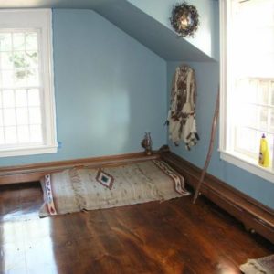

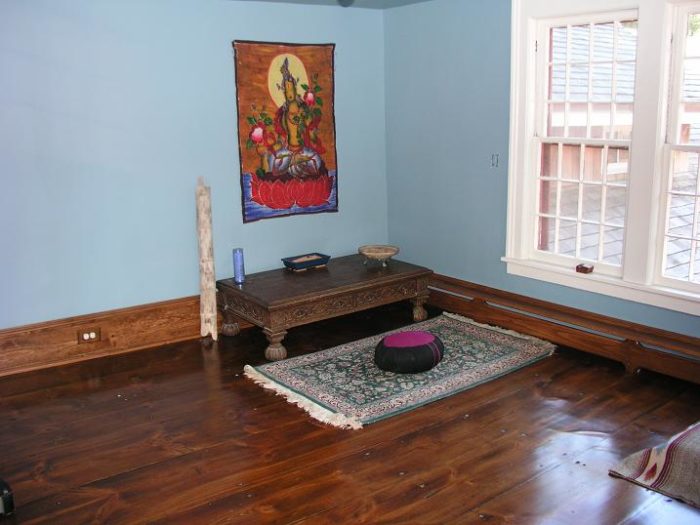

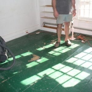

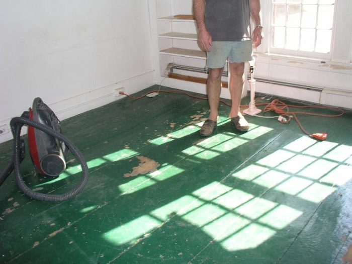

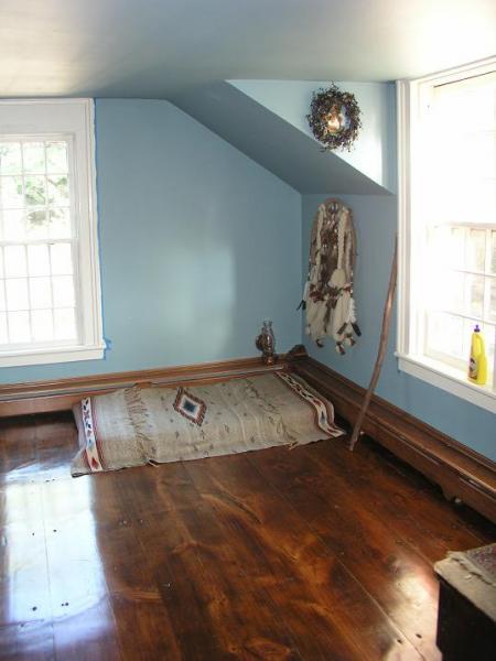

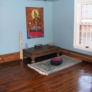

    HUH??? Why would anyone want to paint wide plank pine flooring???
    I just spent months stripping the stuff off...oiy
